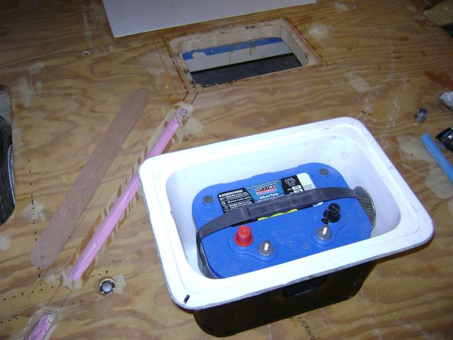

Postby 101camper » Wed Jan 11, 2012 5:54 am
Check your ground clearance - the battery box is nearly as deep as the axle on my harbor freight. I was unable to find commercial boxes that would work, so my solution was to make one from fiberglass. Ran the wires thru a conduit embedded in the floor to the fuse box in the galley sidewall. Definately a time consuming project, but frees up galley space, and moves 60lbs of battery next to the axle.

Postby Woodbutcher » Wed Jan 11, 2012 8:29 am
Thanks for the info. My thought was to drop it near the axle also. I was hoping someone had a nice metal box with a flange on it to hang through the floor. A heavy battery bouncing down the road in a wood box could be a problem.

Postby Woodbutcher » Wed Jan 11, 2012 1:27 pm
That sound good but how will Bobs brackets work to keep the battery out of the weather. Being under the trailer it need to be sealed against dust and water at road speed. I may use an ammo box and cut it shorter and bend over the top edges to make a flange. This would stand up to the elements.

Postby Woodbutcher » Thu Jan 12, 2012 8:19 am
I was hoping to be able to keep all the battery connections inside the galley. Plus I need to be able to get the battery out easily. So I will continue hunting for a box like 101camper has. I just don't want to start a fiberglass project.
