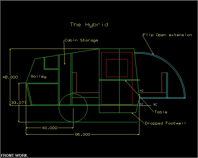

This is the "Hybrid", a 4x8 package that opens up into something much larger. Dropped footwell, cushions that form into a nice long bed, additional storage at the foot of the bed for blankets, shoes, or whatever. There's closet type storage at the head of the bed, and there's also a full depth galley.

Mike,
Are all your family fairly short people? :lol:
See Hybrid 2
Andrew

Postby mikeschn » Sun Jul 11, 2004 7:30 pm
ROFL...
Yea, I guess that was designed for midgets!!! Maybe I'll scale that up a bit... :wink:
Maybe I should get your mannequins in cad format so I can test these profiles before someone actually tries to build one!!!

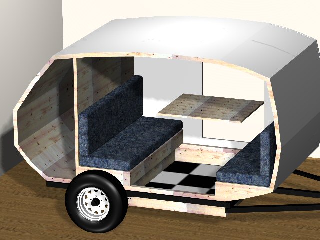

Postby Shrug53 » Mon Jul 12, 2004 12:33 pm
I really like that Matrix. Interesting shape. Really makes nice use of space while keeping a good shape.

Postby RC » Mon Jul 12, 2004 8:41 pm
Sweet looking design Mike. What software are you using to make the renderings?

Postby mikeschn » Tue Jul 13, 2004 4:23 am
I am doing the rendering in my CAD package. Many CAD packages today have that feature. You might try the trial version of TurboCad...

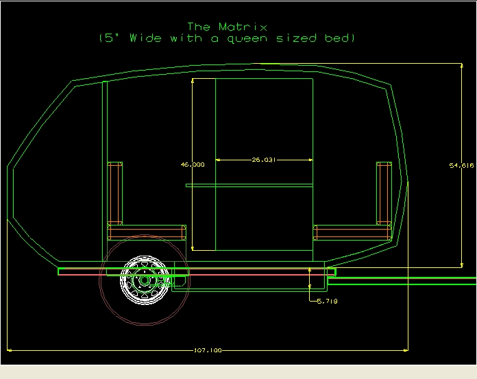

Postby mikeschn » Tue Jul 13, 2004 1:12 pm
Okay guys,
A totally modern looking tiny trailer...
called "The Matrix". There is storage under the seats, and a dropped footwell for total comfort while sitting at the table, and there is plenty of headroom on either size of the table for an average sized person. The dinette converts into a queen sized bed.
