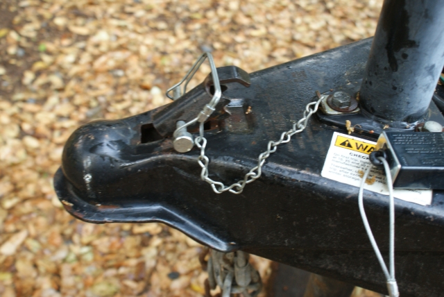

Interesting thing happened to me one day as I always put a pin through coupler! (yes always) and I put it through couple when its parked so coupler can not be closed unless pin (lock) is removed.... Well anyway coupled up and made 300 mile round trip... When I got home pin was missing from coupler WTH????
Now my couple lock pin has safety chain on it (on both trailers)
pin safety chain
This is my car carrier trailer and think somebody actually stole pin at a race event...
