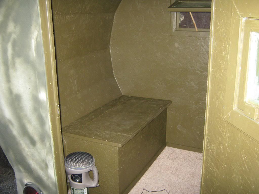

what do you plan on to sit and hold things on the inside?

rowerwet wrote:what do you plan on to sit and hold things on the inside?
I don't really understand your question. In the inside, there will be no moving things once I strap the battery down. On the outside, I fabricated legs that I welded to each corner to ensure it will not rock, I will take a couple pictures of the legs and post them. Raining here and already as dark as a bear's ass outside.

Postby mikeschn » Sun Sep 30, 2012 5:51 pm
I think rowerwet was asking what are you going to sit on. He didn't realize you had a bench opposite the blind window. This photo should clarify that...
