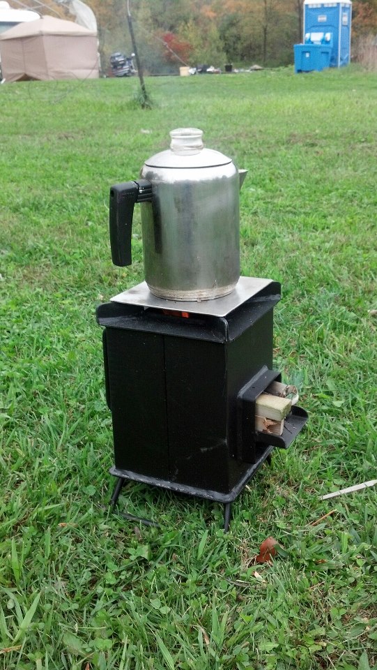

Well you wouldnt want to heat a trailer with a rocket stove, no chimney and from what Ive experienced with mine and read, they are insulated to direct the heat upwards, the sides get hot but not as hot as a woodstove. Image
Mine was made by Grover http://www.stockstorage.com/ and I have a piece that slides in for burnin charcoal as well....
The only problem with a woodstove that is small enough to fit in a TD/TTT is that it will have a real short burn time, maybe a few hours...I sleep soundly lol. Now I was contemplating the idea of some small paper bags with a few self starting charcoal briquettes pre made and if you wake up cold toss it in and light it and it will start burning much faster. I do really like a wood stove and not worrying about runnin out of propane in the middle of the night...hence why i traded away my propane cookstove and now just have the rocket stove.
I like the look of these and can burn coal in them and they arent super expensive http://www.fatscostoves.com/... these are the Cadilac of boat stoves, but your payin for it http://www.marinestove.com/ ... these are a little cheaper and made right here in Pa. http://www.shipmatestove.com/Results.cfm?category=6 ...These are real nice, not as expensive as other stoves but its an import so its gonna cost a few bucks http://www.windysmithy.co.uk/index.htm ...here's another imported stove that looks interesting and is small http://www.salamanderstoves.com/docs/52/the_pipsqueak/#.TtToFfS-k6Y.facebook

I just put a wood stove in my 10 foot Scottie this last weekend. I built it out of 1/8" steel in highschool to put in my ice shack, I've gone through 5 or 6 shacks since then and the stove was installed in all but one of them. It is about 8" tall 8" wide and 10" long. There are a few problems with having such a small stove. The firebox is so small you have to cut you firewood very small and because the firewood is so small it burns up real quick which means you have to constantly reload it. Also having a stove in such a small space it is very easy to over heat the camper and have it 90 degrees at the ceiling and still cold at the floor.
To solve the over heating problem I have found that if when I first light a fire I let the stove heat up to get the camper warmed up quick then I pile bricks around the stove. The bricks absorb the heat from the stove and prevent the camper from overheating and once they are nice and warm they radiate there heat out and the fire can die way down. Doing it this way makes the camper more comfortable and means I don't have to constantly be adjusting the vents on the stove an feeding it as often.
The weight of the bricks would be a problem if I planned to move the camper several times a week like I do in the summer. But I plan to only use it for deer hunting and then once the lakes freeze over I plan to park it on the ice all winter so the extra weight isn't much of a concern.
