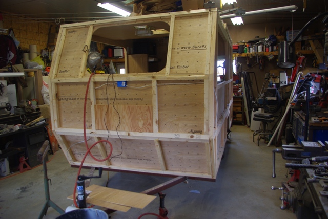

Im building a semi standi 5'6' in front and 6' in the back im going to use extruded foam and hard board outside
any ideas about covering the hard board has any body used FRP on the out side how does it hold up to
UV the trailer is 6' wide and 12' long
thanks
