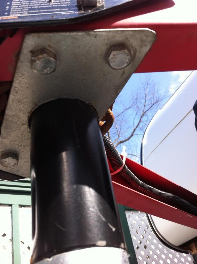

Postby len19070 » Thu Mar 14, 2013 1:49 pm
mcwbyu82 wrote:Do you leave the original bottom plate on or have to take it off?
(I am sure it would be obvious if i was looking at mine but I am at work :) )
Yes, you leave it on. And you have to make a hole in it to accommodate the jack.
If you don't and bump the jack you'll bend the coupler.
I did mine with a hole saw.
Its really a more professional looking set up. Replacing what I call the "Harbor Freight Knuckle".
I'm all about looks. I'm very shallow like that. :lol: :lol:
I'll try to get a photo.
Happy Trails
Len
