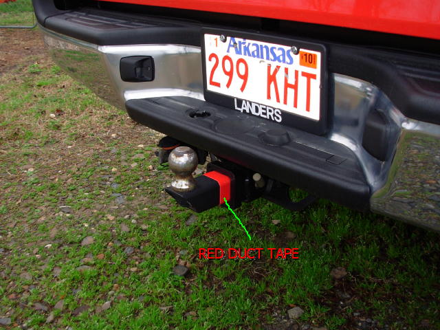

Postby Nobody » Sun May 12, 2013 12:03 pm
danlott wrote:I have wrapped black electrical tape around mine in the past. Works great.
Dan
Ditto, 'cept I used red duct tape. Put it on in 2008 (maybe early 2009) & after 4yrs it's still working great. Have towed the TD, boat, & couple of utility trailers many thousands of miles, silently... ;)

Re: Coupler wobble
Postby tonyj » Sun May 12, 2013 1:11 pm
Really, Harvey? Red?
Red duct tape should only be used for racing applications! Since our campers are usually registered as utility trailers, the choice of duct tape color is either grey or black.
Blue or green is for boat trailers. Yellow for backhoes and bulldozers. White or beige for larger camping or travel trailers (pay attention, Thomas). Choose brown if you are only planning to haul a$$.
Sorry for the hijack, but I couldn't resist ( and i am now going out to wrap some duct tape on my hitch to quiet that annoying rattle i have live with for 10 years! You people are geniuses!).

Re: Coupler wobble
Postby danlott » Sun May 12, 2013 2:31 pm
Dan
Duct tape works well too. I used the electrical tape, because that is what I had with me when I got tired of listening to the rattling.
