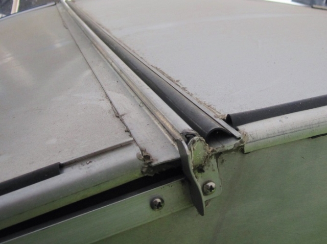

I think a lot of it depends on the radius of the curve where the hatch is hinged, the start angle of the hatch from the rest of the roof when the hatch is raised, & the location of the hinge on that radius. I have the non-offset 'Better Than Hurricane' hinge that I ordered from Grant in 2006 when I built my TD. My hinge is located fairly high on the radius but when open, my hatch sits at a 'start angle' of near 90 degrees to the slope of the roof. This causes a 'dam' effect during heavy rain as the water cannot drain off each side fast enough to prevent some water from 'curling' around through the hinge joint & entering my galley. I usually just clamp a 6x8' poly tarp on the hatch about 8" above the hinge & stretch it forward with bungees. That prevents water from reaching the hinge & getting into the galley. Only problem with that is I have to 'un-clamp' the tarp to lower the hatch at night or when leaving camp for whatever reason. I'm planning to obtain a strip of EPDM rubber roofing material (or perhaps some inner tube rubber) & install it similar to the fire hose that nrody used on his TD. I figure if I leave an inch or so at each end of the hinge it should prevent most water from entering through the hinge. I may even be able to remove the vinyl trim strip on the 'cabin' side of the hinge, place the edge of the EPDM under the slot, & by removing & re-installing the hinge attachment screws a few at a time, avoid having to drill additional holes in my roof to install an additional aluminum 'keeper' strip on the upper side. I'll still hafta install such a strip on the hatch side of course & maybe a thin one on the upper side to prevent screws from damaging the EPDM when they're tightened.
Hatch open
Water enters all across the length of the hinge when it this position. The 'deflectors' make no apparent difference whether tight against the ends of the hinge or slightly loose as shown. Pretty sure a 'shield' of some kind that will assist the water to 'run off' before it has a chance to enter the hinge will alleviate the problem...

Postby grant whipp » Fri Sep 27, 2013 10:11 pm
The more I look at this problem, the more I'm convinced that a bit of weather seal that squeezes against the lip of the "crown" is the solution ... I think I'll do some experimentation ... :twisted: ...! Stay tuned ...

Postby Nobody » Sat Sep 28, 2013 10:19 am
Mike, I have little if any leakage when my hatch is closed. Unless we're just camped overnight I always have one of the First Up canopies over the hatch/galley portion of my TD. Problem is when it rains the water runs down the roof slope & usually 'pools' (at least some of it) at the hinge before it is able to run off either side of the TD. That allows it to 'curl' around thru the hurricane hinge mechanism & leak into the galley. My clamp/tarp arrangement does a good job of preventing that but it's clumsy & not very handy to use so I'm thinking seriously of adding some kind of 'shield' similar to nrody's solution. May hold off a little while to see if Grant's experiments confirm that a piece of strategically located weather strip will do the job. Would probably be an easier (I'm always for that ;) ) solution...

Postby grant whipp » Mon Sep 30, 2013 8:18 pm
FYI ... preliminary tests look very promising for running a strip of Door Seal along the length of the horizontal flange on the hatch side hinge piece, where when opening, the seal is pressed along the length of the "crown" of the hinge, thereby sealing out any water intrusion with the lid up. I'm going to test another style of Door Seal, then figure out a way to water test to confirm my theory, and take some pictures. Stay tuned!
