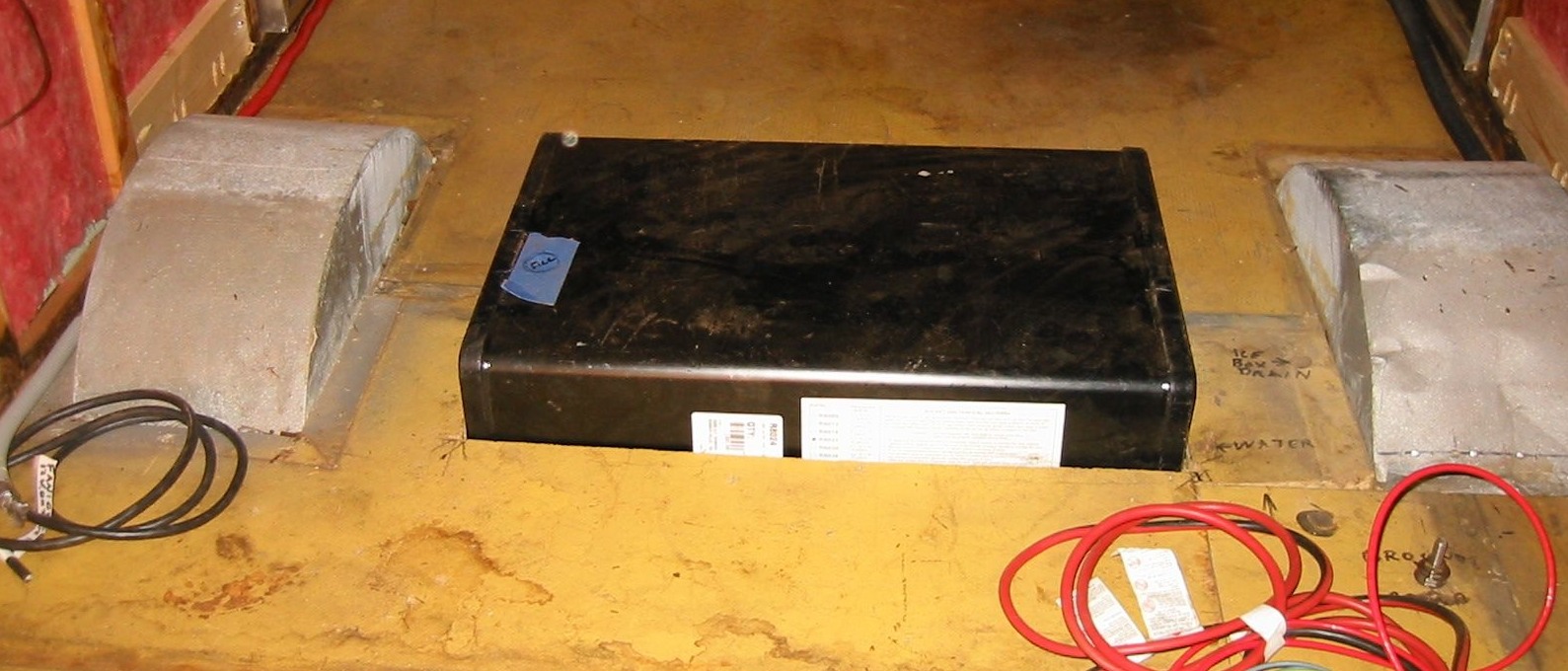

Postby phredathevanet » Sat Oct 12, 2013 11:26 am
Directly over the axle seemed like the best place to mount a tank.
I found a rectangular 12 gal. PVC tank online someplace. There is a limiter over the axle so it doesn't go too far up, keeping the tires from hitting the wheel wells, giving me 5 inch clearance below the floor. The bed was raised to clear the wheel wells. This gave me 5 inches above the floor to mount the 8 inch heigh tank.
I welded a sub frame to mount the tank.

Bruce, that tank must be sitting behind the axle. Until I figured it out it looked like it was sitting on the axle. That is the exact set up I want to do but because of previous commitments from the propane tank mine has to sit directly over the axle and can be no higher than 5 inches, Thanks for the help everyone.
