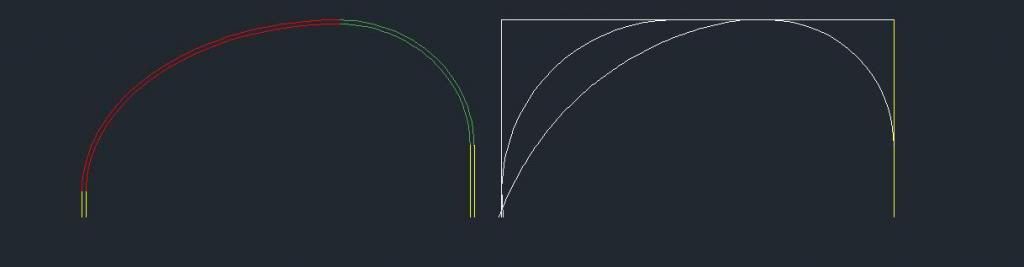

ok i have two questions relating to each other
i have built my chassis it is a set width 1550mm and length 2400mm to late for change now
1 my plan is to use 25 x 25 mm box section to from the profile of the side of my TD then weld that to my chassis brace it then sheet it from there but i no longer have to tools to roll the box my self after work closed down now the profile i have decided on is two sectioned eclipse but every shop i have gone to tells me its to hard :NC
so i was wondering if there was any way to bend roll the profile i wont without the tooling
2 failing that i have redrawn the profile and made it from radiousses this will make it easy for the shops to do the work but it limits the room i was saving for a gallie meaning it might not be worth wild making a rear hatch if i dont have a gallie so i am after a quick poll drawing on the left or drawing on the right the one on the right has two options the top profile or the lower profile
thanks for any input

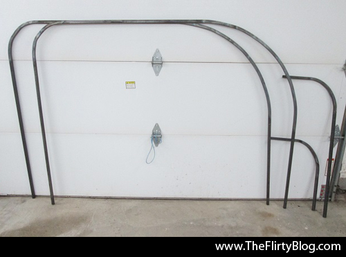

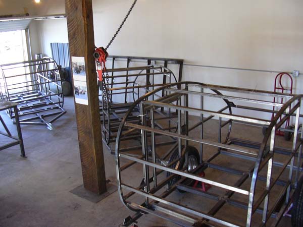

I have built 2 tears with 1 inch X 16 gage steel box tube. I did the roll, cut and weld method. I built a roller and rolled shorter lengths of tube and welded them together. The profile was drawn on the shop floor and the sections of tube were matched to the profile.
There are some pictures of my build in my album. Good luck with your build. I think the metal framework is much lighter than wood.

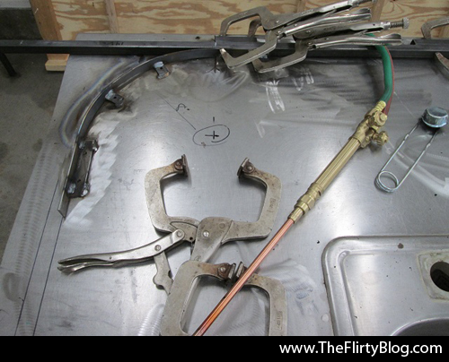

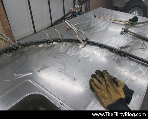

    Dean, In order to keep your original profile, another possibility is using a torch with a rosebud tip. Lay out the profile on a full size welding table, temporarily weld a jig of steel flat bar and carefully bend & clamp the tubing to the jig.
    Examples:
    :peace: Fred
alaska teardrop
