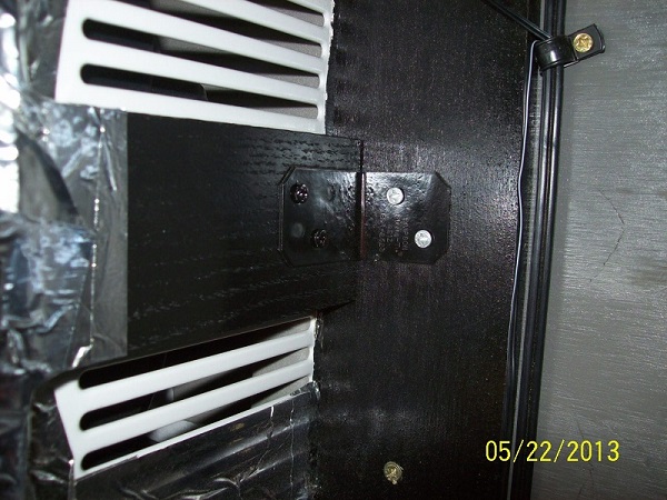

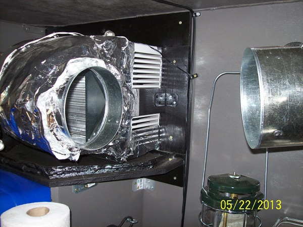

Postby working on it » Sat May 10, 2014 11:25 am
Mine is an LG, model LW5012J, installed permanently; it's mounted thru the rear 3/4" bulkhead wall (opening cut to minimum size, just enough to "squeeze" it into place). The A/C has a bottom channel that rests on top of the wall, and another top piece that both locates the A/C in position (I used 1/2" oak boards on both sides of the wall as a "surround" to clamp it in place, with 1/4" bolts), and angles the unit rearward for proper drainage. I built a drainage system, to fit under the unit (and the 90 degree-turn ducting), that also serves as a support stand for the unit, and as a housing for the water jug at camp. After about 750 miles total road miles travel, there's been no hint of the unit becoming loose in its mounts, as it is only 42 lbs, and secured well.

Postby working on it » Sat May 10, 2014 6:13 pm
...here are better views of what I constructed (detailed in post above):
unit resting on pan; 90 degree-turn ducting
brace close-up
