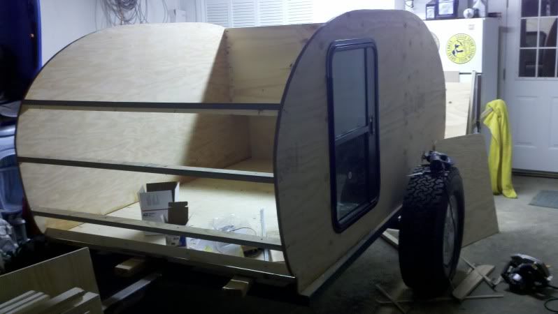

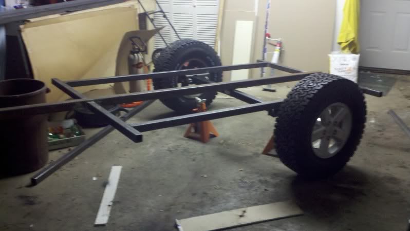

Here's what it looked like new:

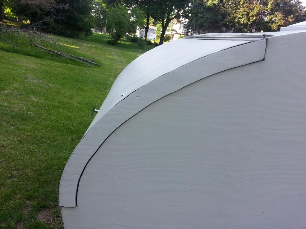

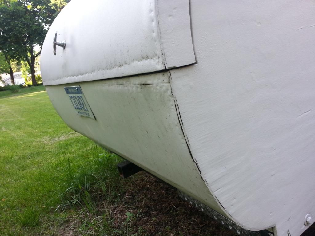

Here's what it looks like now:
http://i622.photobucket.com/albums/tt303/oz97tj/Teardrop%20build%202011/20140601_182043_zpsqs9psk1o.jpg

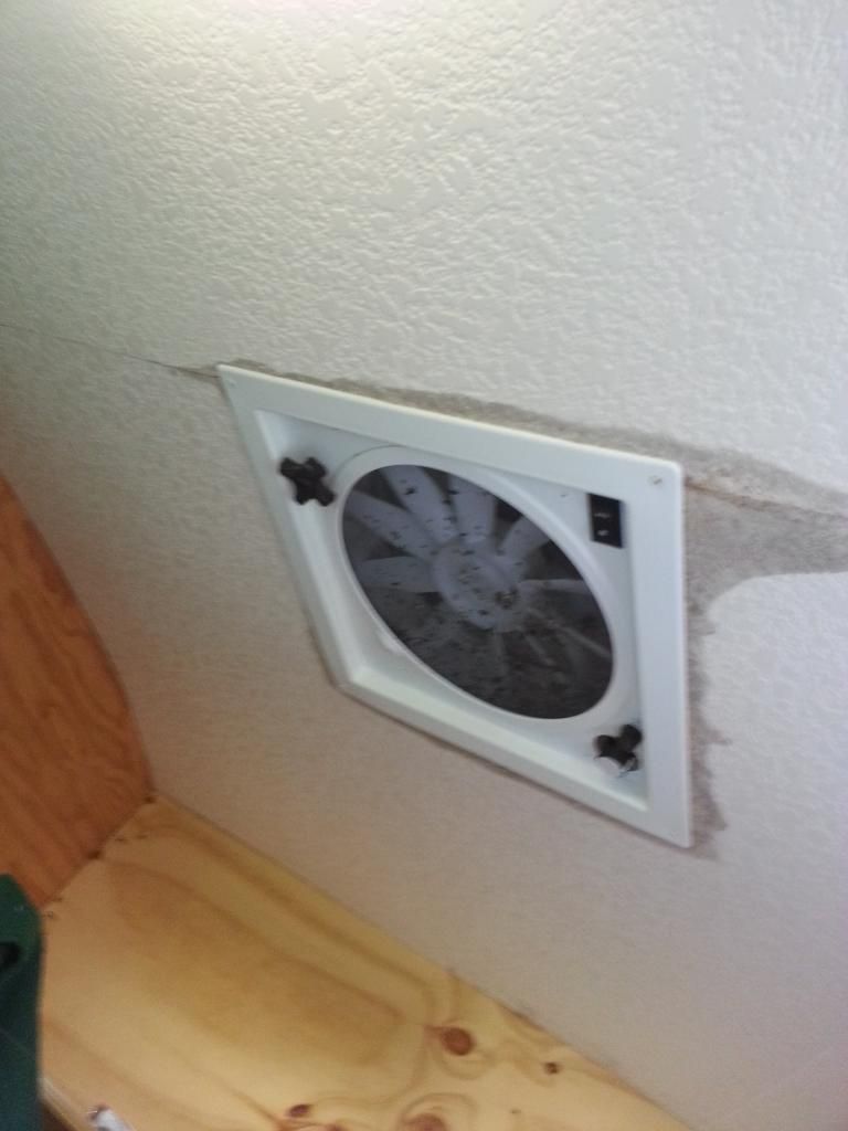

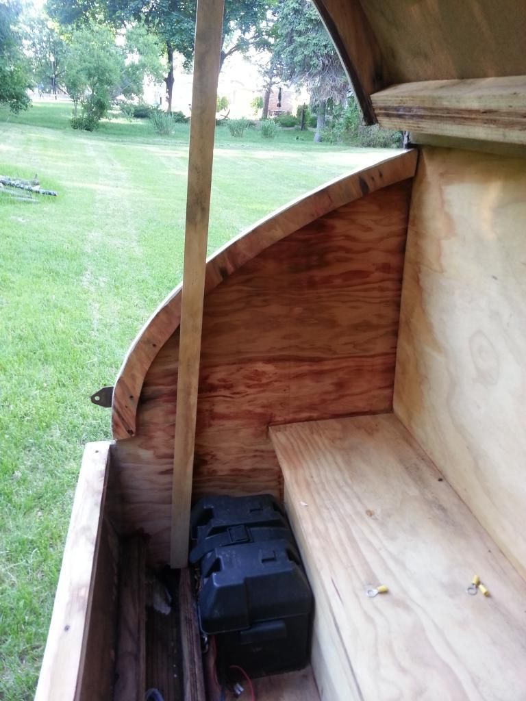

So the biggest issue is the masonite separating from the plywood. He said the roof vent was partially open and that could have caused some of the water coming in. Or possibly the huge cracks between the masonite / plywood. Also the masonite covering the galley area has a couple holes in it from a mishap with the chunks of prop wood he was using.
Assuming that the masonite or the plywood isn't too far gone, would it make sense to skin over top of it with aluminum and silicone/screw it down or would it be better to remove the existing masonite and replace?
Any glaring issues that I'm not seeing? The inside plywood definitely needs to be finished to help protect it against moisture. I would also like to make some improvements as well, like cupboards, 12v outlets, etc. but my main concern is making it water tight/structurally sound first.

From your photos, it appears the plywood is delaminating, and the masonite is weak at best.
Skinning with aluminum, and aluminum trim, if done correctly will prevent further damage.

There looks like there's quite a bit of water damage, especially around the vent. The plywood looks like it's got some damaged walls and delamination in places. There's obviously some sealing issues on the hatch. Who knows what you would find under the masonite. Water has gotten in those big cracks and been trapped there. Personally, I wouldn't trust any of the wood, especially if I didn't build it and know what's going on.
I would tear it apart and start from scratch. It looks like all the fixtures are good. You've got the frame, wheels, lights, fan, latches, and good doors. I'd start over before putting money into repairs.

I emailed to ask if any of the plywood was de-laminating and this is the response I got:
"No. The plywood is all solid. The only damage is the masonite fiber paneling has gotten wet causing the swelling you saw in the photos.
If it matters, the plywood used was a cabinet grade 3/4 inch 4 by 10 ft. The finished side is facing to the interior as it would give a great smooth finish painted or stained. The exterior shows the wood grain more than I anticipated it would through the epoxy. If a guy was ambitious, you could use some filler and sand the sides smooth when it was reskinned. Then epoxy over the whole thing creating a smooth fiberglass like finish. Another option would be to glue some of the masonite paneling over the sides and then re-epoxy. That would also give the same effect.

Postby Campin' Texan » Mon Jun 02, 2014 11:04 pm
This looks like the edge of the side wall is delaminating.
This looks like a lot of water damage
With the big cracks letting water get to the wood, and all the water around the fan, there's no way I'd call that plywood "solid". Unless the pics are just making it look really bad, I think it's got a big head start on rotting. The grain showing up could be an indication that the plywood has gotten wet and as a result the grain raised up. Cabinet grade plywood isn't made to be used outside and has to be properly protected if used in an exterior application.

As pointed out by the other poster, this appears to be delamination on the sidewall;
It is very likely, probable in fact, that mold is present in the ceiling cavity, and in/on the wood in other areas.

Rob, to answer a previous question, the asking price right now is 1200. It it basically a new trailer frame and axle, newer jeep alloy wheels, newer 31" BFg at's, doors, vent, the leakproof galley hinge, etc.
He is saying the plywood is not delaminated and it's just the rough side of the plywood. Assuming this is the case and I check it out before I buy it) Would it really be a big deal to pull the roof and galley skin, check for mold, insulate, replace the Masonite if necessary and skin it ?

Looks like a good frame and probably some useful fixtures to me, but the seller either isn't being straight with you or just doesn't know what he is talking about. With the level of water stain on the inside or the trailer, he DOES have delamination. There's no seal at all on any of the corners from what I can see.
My best guess without walking around the trailer would be that you are looking at replacing the ply, then skinning.

mikesova wrote:He is saying the plywood is not delaminated and it's just the rough side of the plywood
"Cabinet grade" plywood doesn't have a rough side. This looks like standard 7-ply plywood to me, and it sure looks like it is delaminating at the edges. It certainly is not anywhere close to the grade of plywood that I would use in my cabinet work.
It looks like it has leaked from virtually every seam, and it is pretty inconceivable that it doesn't have some rot. In one picture, it sure looks like there is some mold bloom.
There are easily $1000 worth of parts here, so it may make a good buy to start a total rebuild. But, as it sits now, you could definitely make it watertight and usable for a few years, but for all that expense and effort, you will always have a cobbled-together low-quality build. Is that what you want?
As for using it for a trip in a few weeks, ... A teardrop is a very small, enclosed air space in which you will spend 1/3 of your total time for the duration of your trip. That is a lot of time to breath in the air, and whether it be moldy air, or air laced with chemical residues from trying to kill the mold, I value my health too highly.
