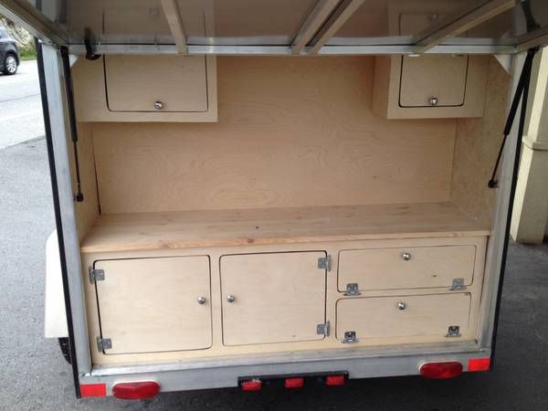

not sure if my is a ''grassopper but here s what i came up with, it s functional. the only issue been that the door could be a couple inch higher...

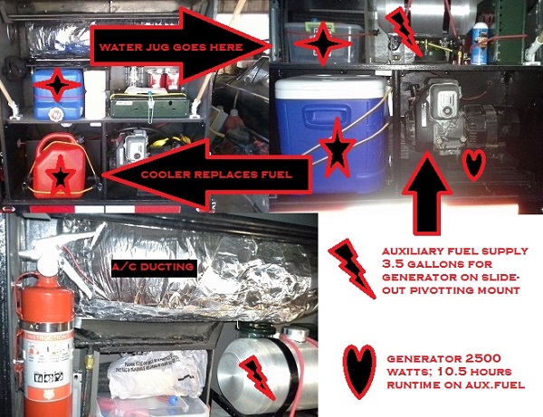

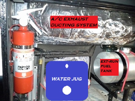

OK, mine is not a grasshopper, nano, or weekender, just an overstuffed "Simple". But, it's got a lot of equipment in its' vertical "galley". I built it vertically, 20 inches deep, allowing 76 inches inside the cabin for a twin-size mattress. I chose an angular form as the "simplest" way to create a TTT with limited woodcrafting skills, more conducive to a successful outcome, given my bolt-together background. I intended to put a "kitchen" back there originally, but I chose to go with side-tables for food prep, and only have a water jug and a cooler, and my dual-fuel Coleman gear and fuel (as kitchen stuff) back there. The remainder of the space (20" deep x 48" tall x 46.5" wide = 25.83 cubic feet) is dedicated to power or A/C
  • a) 12vdc power connections-hidden,
    • 110133
    b) 120vac power supplies-2500 watt generator on slide-out turntable w/ extended-run fuel tank!
    • 120568
    -or- park power thru 12ga extension cord (w/ GFCI & Surge protection),
    • 123160122999
    c) 5000 btu A/C exhaust ducting system.
    • 108160
The generator and peripherals, and A/C ducting were my primary focus in constructing the galley. I had a plan to fit them in, regardless. So, the domestic operations of the galley were dismissed. The A/C was to be able to run with the hatch closed and locked up for the night (so no mischief would occur), and the generator was there to supply power in boondocking situations where no park power exists. To do it over again, the generator would've been in a box on the tongue, and the A/C ducting would've been routed straight back (thru a small, louvered hatch, inset in the main hatch)
galley, A-C ducting, water, fuel, generator layout.jpg (148.27 KiB) Viewed 1408 times
upper galley details.jpg (94.23 KiB) Viewed 1408 times
Remove the generator and fuel supplies, re-route the A/C exhaust, and there's ample room for counter space, stove, and heated water supplies. But, beware of possible rearward weight bias-mine was substantial!
Last edited by working on it on Thu Aug 14, 2014 11:16 am, edited 1 time in total.

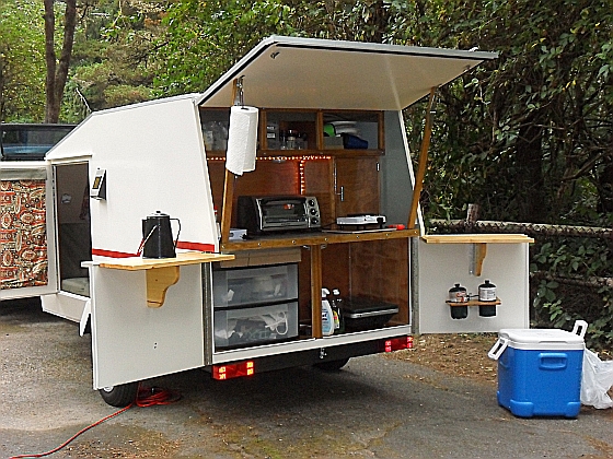

Here's how ours looks:
This year I finally added a slide out for the cooler (sorry no pic)....I really got tired of lifting the cooler in and out of that space!

Wow! Just WOW. This is my dream galley! So well thought out. Great job.
rmclarke wrote:Here's how ours looks:

Hey Richard, love the barn style lower doors! Is there a build thread of yours on here?
