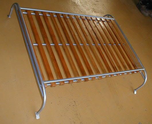

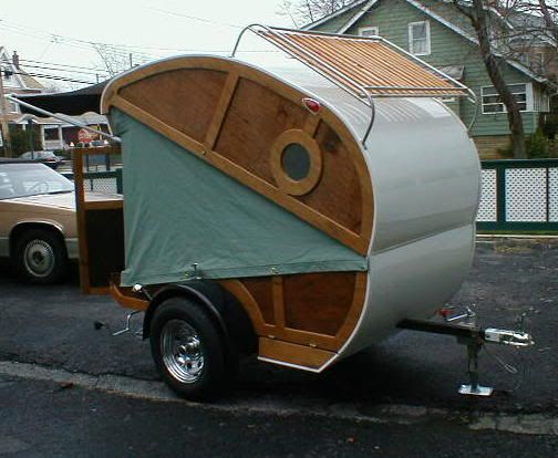

Postby len19070 » Wed Oct 15, 2014 5:28 am
Heres 2 similar ones I built. Made from 3/4" EMT and Cedar slats.
Happy Trails
Len

Postby Aaron Coffee » Thu Oct 16, 2014 7:08 pm
Len,
Thanks for the pictures. At first I was thinking of making more of a safari basket type roof rack, but after seeing yours it looks to be easier to build. How are the wood strips attached?
Thanks
Aaron

Re: roof rack pics and questions
Postby len19070 » Thu Oct 16, 2014 8:46 pm
Aaron Coffee wrote:Len,
Thanks
Aaron
I was going more for looks than function so I attached them fro screws from the bottom.
But as it turned out that was the best way to attache them. the slats were 1/2" and the screws went in without popping out of the top (a ruler helped) and as it was situated, the slats didn't fall UP! lol
I've carried a 16'canoe on these racks with no problems.
Happy trails
Len

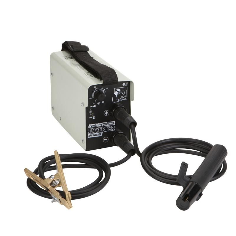

123jay wrote:Lin. How did you weld the EMT?
I have a little welder I got at Harbor Freight.
It was a bit of a PITA.
If you try it though blow a fan on the metal away from you as the EMT is Galvanized.

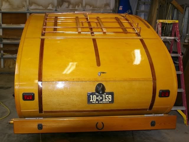

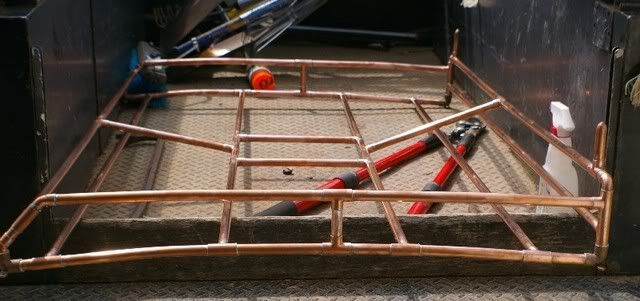

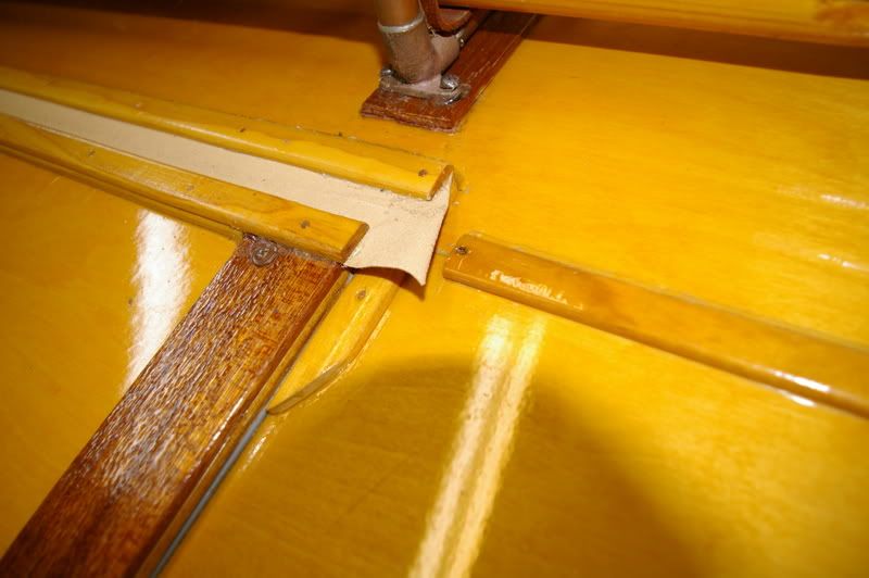

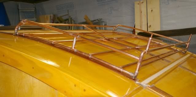

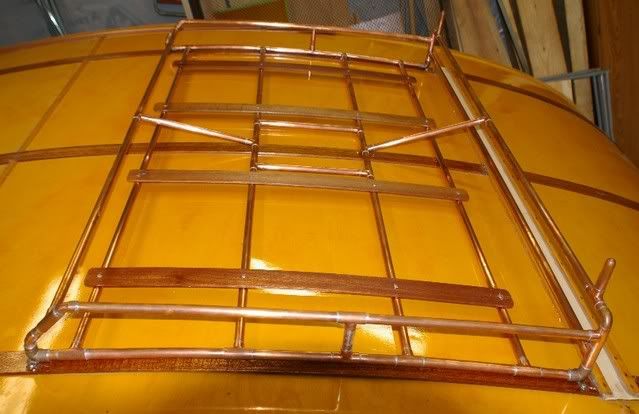

Postby 48Rob » Sun Oct 26, 2014 4:24 am
Copper is easy to work with if you don't weld...you do have to sweat a little though :R
Easy enough to dry fit, then sweat (solder) together.
The feet sit over and are screwed to the spars, and the slats are simply screwed to the tubing.
Rob
48Rob
Posts: 3882
Location: Central Illinois
Postby Redneck Teepee » Sun Oct 26, 2014 8:26 am
[quote="48Rob"]Copper is easy to work with if you don't weld...you do have to sweat a little though :R
Rob
I like it! :thumbsup: That design actually fits this little trailer very nicely. Just keep in mind, to preserve that bright shiny copper look, you would have to clear coat it after you are done or you could paint it the color of your choice, other wise it will surface corrode/oxidize.
Also before applying any coating you will have to be sure and completely remove the soldering acid residual with water and a soft brass wire brush
To get the maximum stiffness and support out of it. you would also use type "K" copper, it has a thicker wall and would be more ridged.
Redneck Teepee
Posts: 853
Images: 21
Location: Central Ca.
Postby working on it » Sun Oct 26, 2014 11:29 am
48Rob wrote:Copper is easy to work with if you don't weld...you do have to sweat a little though :R
Rob
Looks great; complements your paint scheme. If anyone is going to try to copy this, be sure to use type K or L pipe, type M will probably bend. I know from limited experience; I use Pex now. Not sure if Pex would be good rack material, though....
173193172890148599
