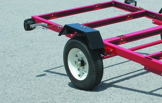

I plan on building a tear on a Harbour Freight trailer or like it. Will I be able to switch out and find wheels that fit that have a vintage feel?

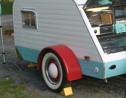

Below shows shows the generic trailer wheels. I prefer to have something like the look of the wheel on the tear drop trailer shown. Any recommendations on trailers that will accommodate that?

Us wheel makes a wheel that looks a lot like the wheel on the trailer on top. I don't know if they make a 4 lug. her is a link.http://www.uswheel.com/products/chrmsmoothie You may be able to use an adapter to go from 4 lug to 5 lug.

By all means go 15" wheels!
Wheels Vintques makes great wheels too! :thumbsup:

I get my wheels from Summit Racing. I went through them for the artillery wheels for the Benroy Woody. They are made by US Wheel.
If you have the lug stud measurements you can look on Summit's web page to see if they have one that will fit.

I just ordered from Rockwell 2ea oem 15'' wheel with the big hole and 2 hub caps part 4650 steel . will paint the wheel and add a outer chrm. ring.
Wheels $31.00ea

A couple of side notes. I see your HF trailer has a 5 lug wheel. I didn't notice that earlier. If you want white walls like in the picture, JC whitney has wide whites for vw beetles. Or if you use a trailer tire, you could look at portawalls.

Just to clarify, those are just stock pictures off the internet, I have not bought a trailer yet. I feel I need to get all my thoughts together first before I start. I want to make sure I pick the right trailer first. Can I add 15 inch wheels to a 5 lug trailer. I'm am not knowledgeable about trailer wheel anatomy :crazy:
