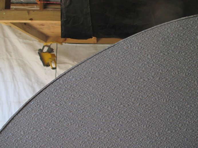

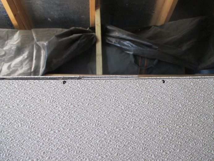

Here are close-ups of the roof/sidewall joint:
