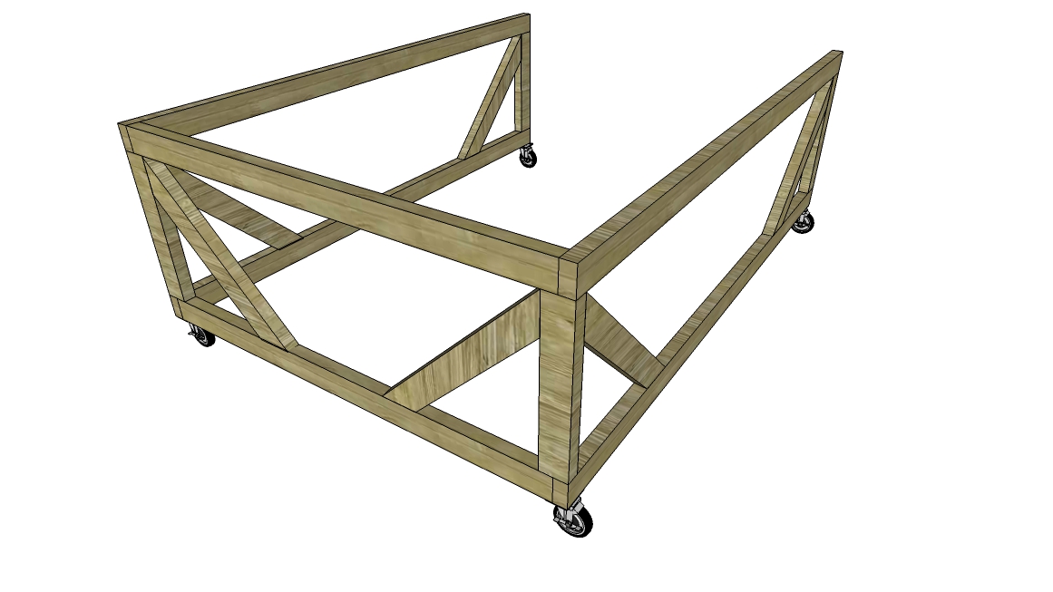

Postby drhill » Sat Dec 05, 2015 5:29 pm
Below is what I had in mind if I want to be able to move the camper unit around in the garage when it is removed from the trailer. I would build two stands with a welded support at each end. It would function much the same as the stand you posted in your first post, but this would be built to be easy to disassemble to store against a wall or lay on the floor and park the trailer over the pieces. It is all about too much stuff and not enough space.

Postby MidTNJasonF » Sat Dec 05, 2015 5:52 pm
drhill wrote:Below is what I had in mind if I want to be able to move the camper unit around in the garage when it is removed from the trailer. I would build two stands with a welded support at each end. It would function much the same as the stand you posted in your first post, but this would be built to be easy to disassemble to store against a wall or lay on the floor and park the trailer over the pieces. It is all about too much stuff and not enough space.
137937
That was a very quick sketchup on my part. I would probably do it with a few thru bolt per corner and nut inserts in the mating piece. It would be three flat sections that way.

Postby Vedette » Sat Dec 05, 2015 6:13 pm
Things that are up in the air have a further distance to fall. :twisted:
What kind if lift system are you going to use to lift this camper pod on and off of the trailer?
There are two schools of thought here. :thinking:
1.You can keep it simple and jus buy 4 small snowmobile dollies to set it on (about 6 " off of the floor) 4 corner steering.
2 you can build a simple 2x2 1.25 wall frame the exact size of your pod c/w large swivel casters or wheels adequate for the weight. To lower the pod unto while not in use. If you want to store camping gears, under, not on top of the pod. then you can make tis stand higher with a lower shelf at the 6" level for your camping gear to be stored.
The beauty of option #2 is that you can put a dust cover (cheap car cover) over the whole thing and roll all of your camping needs into one corner of your garage or storage area. :thumbsup:
