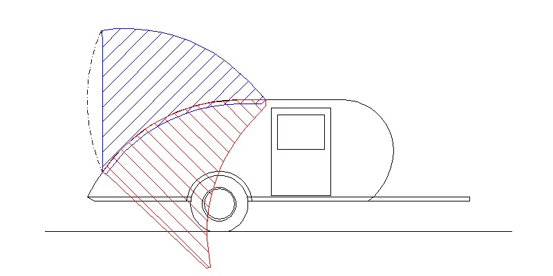

Doing a clamshell top on an un-modified Kampmaster design would not work, as the sides would stick through the ground when the roof was down, which would make towing hard.
Blue is roof up and red is roof down:
One way round this is to make the side panels completely removable - if they are made of 1/4" ply with light framing and a couple of good handles, you could just pick them up and store them inside when towing.
