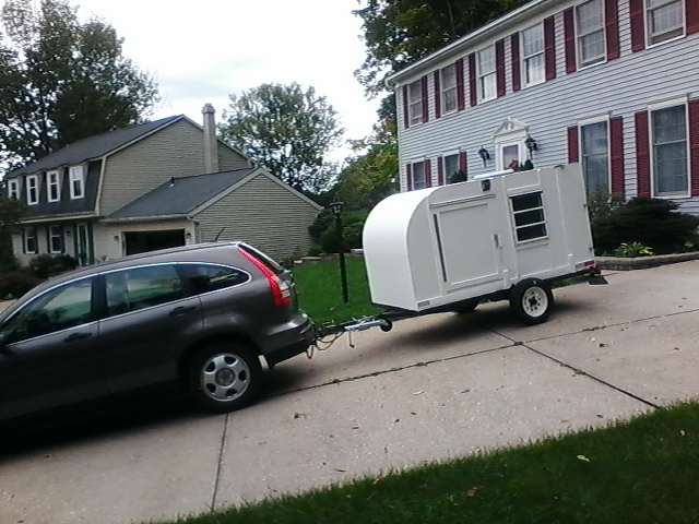

Postby Tomterrific » Fri May 06, 2016 7:33 am
I built my 4x4x8 out of cheap 5mm underpayment and cheap 1x furring strips. The stiffness of the thin sidewalls is from furring strip battens on the outside. The one heavy plywood used is the 3/4" floor, both for utility (motorcycle, furniture, etc...) and a truly flat sleeping platform. It is very light! Towing at speed shows poor aerodynamics.
T
Full of furniture.
