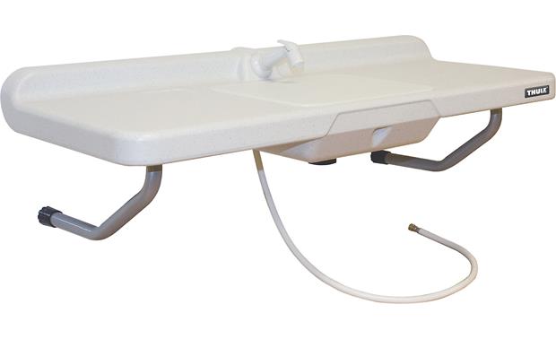

My Google foo is weak today. I want to make my own Thule sink and having a hard time finding the legs/braces that attaches to the bottom of the table and braces against the TD side.
Picture of the sink I'm talking about:
I know I've seen these someplace and it's driving me up the wall trying to find them.

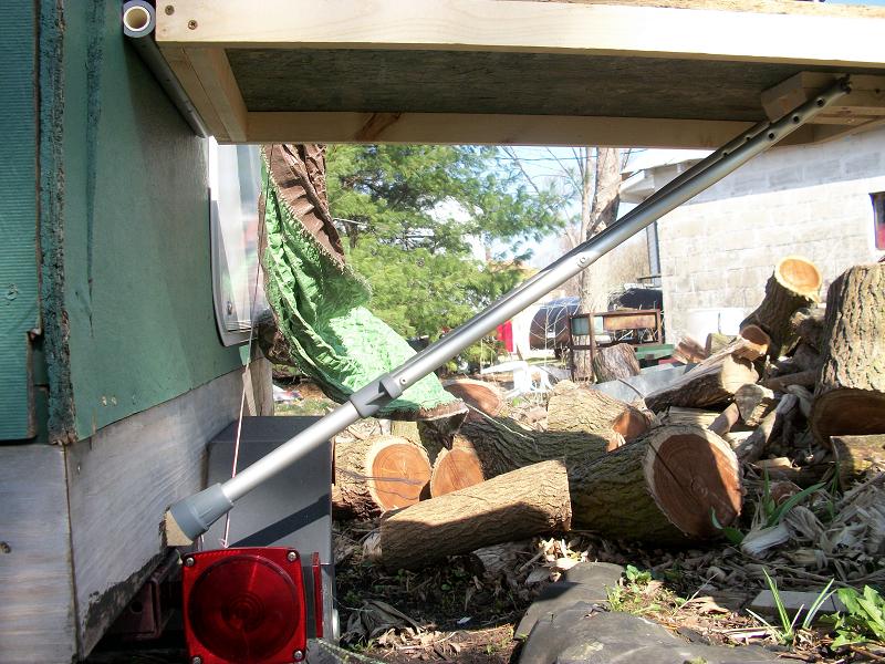

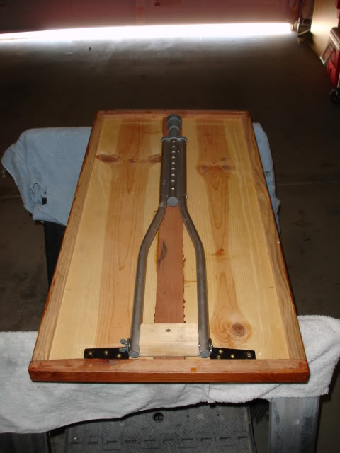

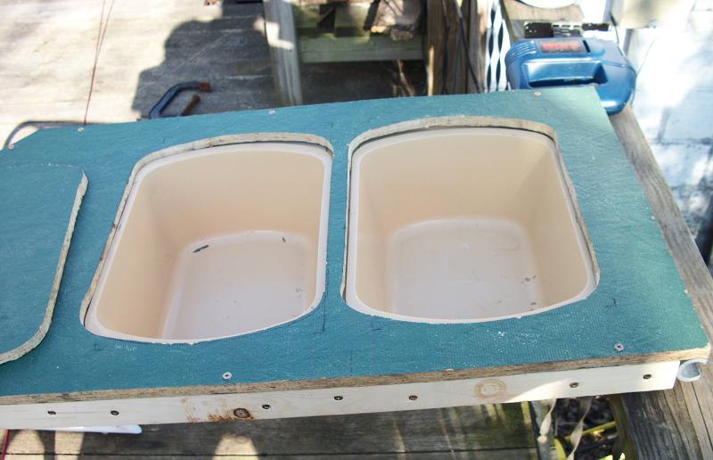

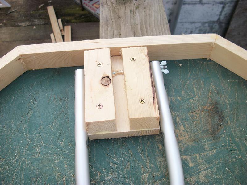

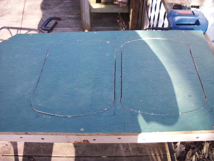

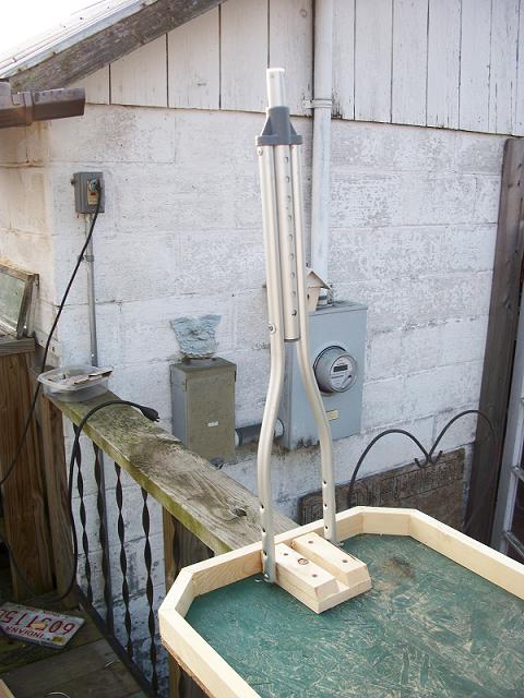

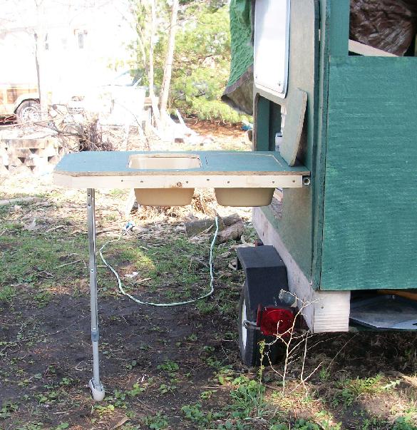

"So-Cal" Teardrops uses this same support system for their side tables. Don't know if they would let you know where they get them, but you can find them here on the internet and could ask. I myself, was looking to go with this same setup also but realized folded for storing, they would be just too thick being I wanted to have 3 side table's stacked together for travel and there just wasn't space for them unless I had separate - detachable supports which is why use my "crutch' supports which are made out of crutches from the Goodwill. They work fine and are adjustable and really draw the comments from others. My side table "sink" has two 11 inch holes cut into it which two stainless salad bowls (11 inch dia./5 inch deep) fit into when cleaning along with also being useful for other things when traveling.

Postby bobhenry » Fri Jul 01, 2016 7:09 am
terrain adjustable table leg ......... Here's Cliff's Image
Here is mine .........

crutches are so 'adjustable' and just "Cooler" plus the senior second hand store always has them in stock for about 2 to 4 dollars a set. (found this out after I paid about 30 dollars for the new set I bought first - live and learn) wood could considered being environmentally unfriendly and wasteful being crutches are so available!! this is just an opinion ------------------------ :thinking: :thinking: :thinking: :wine: FARM Gathering in 2 weeks!!! :beer: :wine: 8) :thumbsup:

bob, that is absolutely BRILLIANT!
