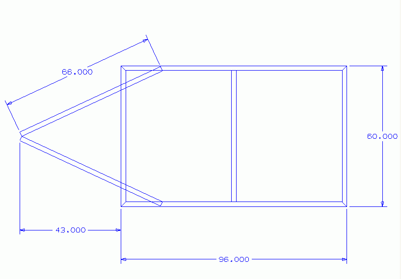

Here's the trailer we are going to build? Any comments? Thoughts?

I'm going to build the frame out of 2" square steel tubing. What thickness wall shold I get? Here are my choices...
.065
.083
.120
.145
.188
I already know the 3/16 is too thick. Is the 1/16 too light? Should I be using 3/32 wall? Your thoughts?

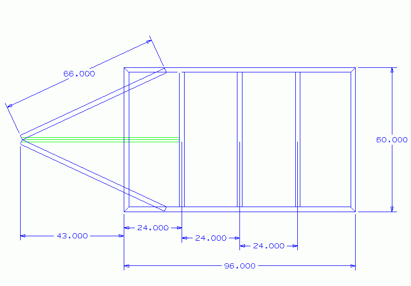

Postby mikeschn » Tue Aug 10, 2004 7:09 pm
Okay, per Franks directions... I've added the centerrail... what do you think...

I'd let the welding process used detiremine the thickness of the steel. I TIG welded mine using 0.120 wall 2" x 2" square tube . For stick or MIG I'd use the 3/16 wall or heavier. I don't want to think about a trailer gas-welded out of 1/16" tube!
I wasn't too concerned about the beam (vertical) strength of my frame, but rather the twist from my torsion axle, and the side loading from the tongue. I recomend diagonals in the first bay, and in the bay over the axle. A ladder frame like you drew doesn't have a whole lot of resistance to twist, and might tend to wrack the cab over time. I used rubber mounts to isolate the two. I prefer a single-tube tongue, and next time will use a long receiver hitch tube to connect, and just pull a pin to disconnect.

Postby Frank » Tue Aug 10, 2004 7:17 pm
Mike,
I misunderstood you on the phone, and had not looked at the picture yet. :(
Believe you will be ok with the orginal just use the .125 on the two toung
pieces, and yes thinner on the rest should be no problem. Sorry for the mix-up.

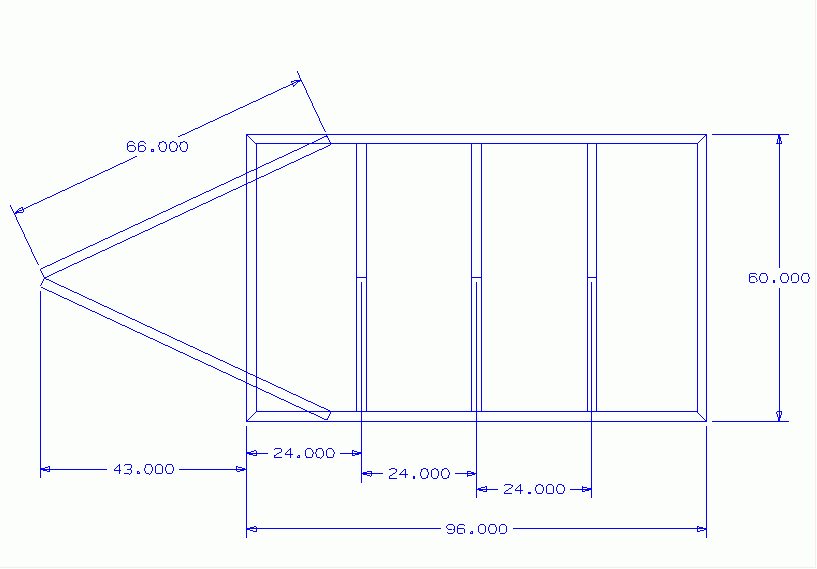

What will that frame weigh? Looks like you have a lot of cross members. Not sure if you need that many. Overkill?
Here's mine (sorry no dimensions on this drawing; outside frame width = 57.5"; total length = 14'). Fishplated at the start of the diagonals, gussets/body mounting tabs at corners.

Postby mikeschn » Tue Aug 10, 2004 7:37 pm
Rik,
If I hear you correctly, you're saying this is enough?
Postby R Keller » Tue Aug 10, 2004 8:02 pm
I'm not really the one to ask about this by any means... But I think I'd want a center tongue piece. And where is the axle? A torsion axle acts like another cross member in the chassis and the other cross members can be spaced accordingly.

Postby Frank » Tue Aug 10, 2004 8:06 pm
Yes and No, Believe you do need the cross members with gussets, (like we did your first one), to stop the twisting Lenny is speaking of. But seeing the tongue going under the "box" welding to the front and side rails in two different locations will be sufficent. You realize I did a combination of what Rik did and what Lenny did. Like you drew in the bolt together verson. But that is just my preference. What you have will work.

Postby mikeschn » Tue Aug 10, 2004 8:08 pm
The axle isn't positioned yet... :(
I expect it'll be about 45" to 50" from the back of the body, but I am going to adjust it after everything is built, and then have it welded in place.
Too bad I don't do FEA!!!
Unless someone tells me otherwise, it looks like it'll be a .083 trailer with 5 cross members, and .120 tongue members...
As such, it's looking to be heavier then I wanted... alas... I have overnight to thinkabout it!!!

Postby Grant » Wed Aug 11, 2004 2:15 am
Mike!
You never said what kind of axle you'll be using. If you're going to use a single piece torsion axle, four crossmembers will be sufficient (axle beam will act as another crossmember), but if you are going to use a leaf-sprung axle, go to five.
To simplify things, make the whole frame out of .120 wall, but if you really want to shave just a few pounds, make your middle crossmembers out of .083, maybe even your rear crossmember.
