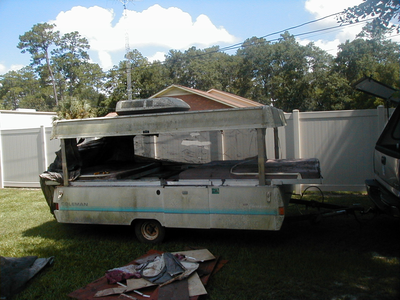

Postby Doublacola » Tue Jan 10, 2017 8:49 am
jandmz wrote:
Doublacola wrote:This is along the lines of what i've been thinking about. I would add several windows.
http://www.doityourselfrv.com/vintage-a ... rt-studio/
The Apache people will try to talk you out of it. They get kinda sensitive about destroying an Apache.
There were a couple years that Apache campers could be ordered without bed ends. They are the shape that you are considering, retain the low profile towing advantages of a popup, and would require zero work converting one, other than what you would do to remodel the interior. They are hard to find, but do come available every now and then. I have only ever seen two like this. Here's a link.
http://www.apachepopups.net/albums/albu ... .sized.jpg
This is what we currently have. The canvas is completely rotted out and so are the trays. We are looking for an economical way to reuse it.
