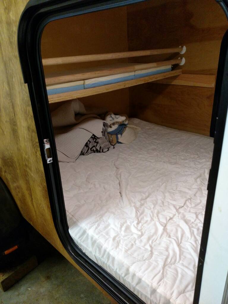

Postby camper4life » Sat Jan 07, 2017 10:37 pm
I built bunks for my two sons.
125284125283125282

Re: Three's a crowd
Postby Dashunde » Sat Jan 07, 2017 10:58 pm
Dashunde
Posts: 7
Joined: Tue Jan 29, 2013 5:21 am
Re: Three's a crowd
Postby Dashunde » Sat Jan 07, 2017 11:06 pm
camper4life wrote:I built bunks for my two sons.
125284125283125282
I really like your layout.. a lot. Great use of space... 4 people, full galley, storage and a/c. :thumbsup:
What is your side panel height?
Dashunde
Posts: 7
Re: Three's a crowd
Postby camper4life » Sun Jan 08, 2017 12:26 am
Thanks! I can't find many pictures of the a/c window unit installed on the drivers side of trailer. In this picture, there is a flip up door next to window. I install a/c when I arrive and depart from campsite.146539

Postby yrock87 » Tue Jan 10, 2017 1:28 pm
I have a crosswise bunk across our feet for my kiddo. the tear is 5 wide so there is PLENTY of room for her at 18 months. and there is tons of room to grow into it. we currently have a pack n' play style mattress cover over two of the visible memory foam chunks on one side of the bunk, it takes up about 3/5th of the length, leaving the other two feet for our duffels. when my little girl isn't so little any more, we will extend the bed space of the bunk. I do still need to figure out a workable cabinet situation that leave room for the bunk, but as pictured got us through a week long thanksgiving roadtrip well.
