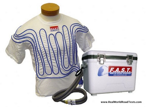

Postby working on it » Wed Feb 01, 2017 10:45 am
Tomterrific wrote:I've had this idea for a long time, longer than most have been alive! As an efficient electric blanket warms by heating the body instead of the air, then a cool sheet would be ideal. You'll need to make your own as I know of none available. Use many feet of vinyl tubing, like aquarium air line, and attach it to the surface of a sheet. Pump cool water through the sheet.
Hey! You asked for creative ideas.
Tt
Here's one; I considered it after a minor racing heatstroke in 2005. Not too comfy while sleeping, I would think.
