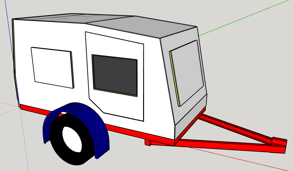

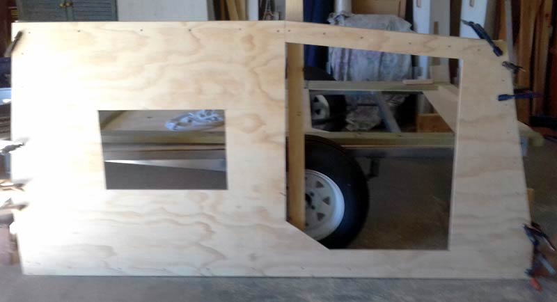

Postby mikejohn37 » Mon Jul 03, 2017 5:31 am
I have designed a squarish camper for my own use. 8 x 4 x 4 roughly.
The front and side hatches are for access to the cabin and for extra ventilation in hot weather during the day. They will be fly-screened. The size of the side hatch is to suit a small air-conditioner and a removable shelf is for that purpose or it could be another pass through opening/table. Maybe it is a crazy idea. The air conditioner only comes camping in hot/cold seasons and is carried in the car.
The bed space is 78 inches long and 44 inches wide. Cosy. It could widen to 5ft but it is meant to be a low cost build and you get more out of plywood at 4ft wide.
The rear hatches are removable rather than lift up so I can park under low trees and they also will have legs and serve as camp tables.
It is a low cost build. No electrics - just camping lanterns etc. I will have an electrician put in one ac outlet if they will.
Questions? Comments?
Mike
Australia
mikejohn37
Posts: 25
Joined: Thu Jun 15, 2017 5:43 pm
Re: Minimalist Tears

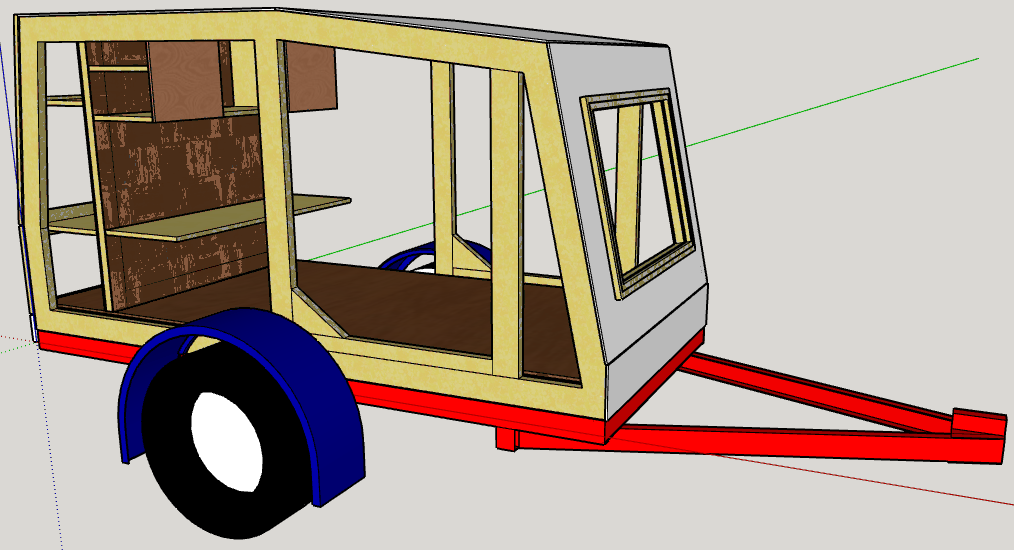

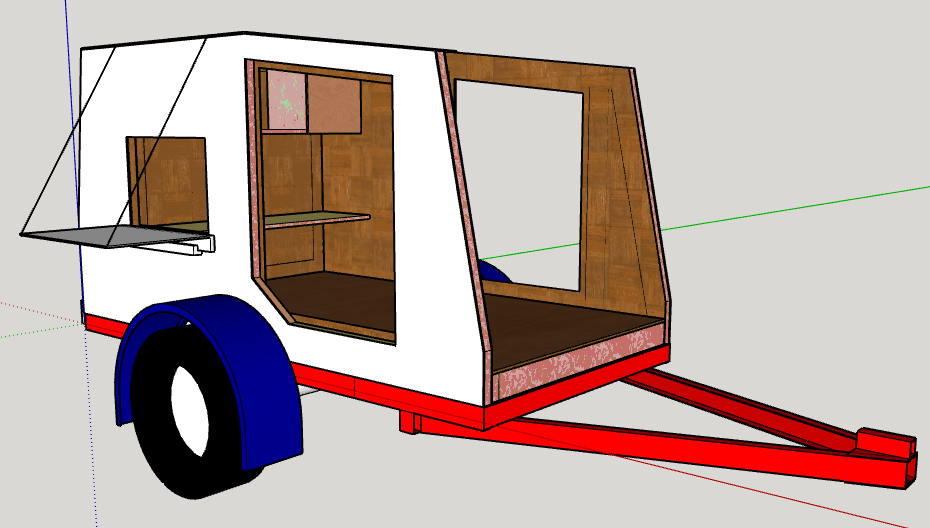

Postby mikejohn37 » Mon Jul 03, 2017 5:33 am
More pics.
mikejohn37
Posts: 25
Postby friz » Mon Jul 03, 2017 8:46 am
My only addition would be a roof top vent with fan and a simple 12v system to power it.
Sent from my SM-G900V using Tapatalk
The "Sin Bin"
150133
friz
Posts: 740
Images: 6
Postby VT800C » Mon Jul 03, 2017 10:11 am
nice design. I like the cables from the top to hold the shelf. and using the covers as tables? ingenious! I'd only be worried about how to seal the openings when closed up. you might find that adding the molding to hold the seals will increase the complexity of the build (I sure did!)
I say go for it! let us know how it comes out.
VT800C
Posts: 42
Joined: Sun Sep 20, 2015 8:34 am
Postby low277 » Mon Jul 03, 2017 11:23 am
:thumbsup: I like it!! Simple can be a good thing!!!!
NW Minnesota
low277
Posts: 192
Joined: Fri Jan 06, 2012 2:11 pm
Location: NW Minnesota
Postby mikejohn37 » Mon Jul 03, 2017 4:52 pm
Thanks for the comments. Now I have to build it. :-) I am going to fibreglass the outside of the walls and tape the outside joints. I need to credit only taking the aircon when needed idea to Coyote.

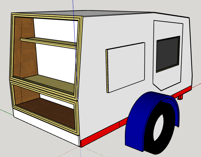

Postby JuneBug » Thu Jul 06, 2017 8:50 pm
Suggestion. For the back, which may be your kitchen, or a place to store other gear. Gather up what will go there, measure and fit accordingly. For example, if you have a camp stove, make sure the depth of your shelf will accommodate it. If you have a specific type of water jug, make sure you can accommodate it.

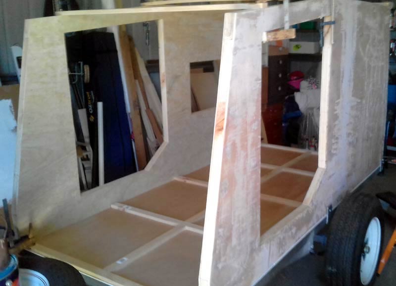

Postby mikejohn37 » Sat Nov 18, 2017 6:54 pm
It is almost done. Filling holes, fibreglassing, sanding and painting to go and then fit all the hardware - locks, seals etc.
mikejohn37
Posts: 25

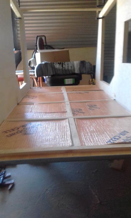

Postby mikejohn37 » Sat Nov 18, 2017 6:55 pm
Sides up and floor in.
mikejohn37
Posts: 25
Postby mikejohn37 » Sat Nov 18, 2017 6:56 pm
End view.
mikejohn37
Posts: 25
