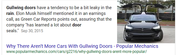

  • Actually, I have no Mercedes, nor a gullwing door, but I've read that the top seal is problematic. Perhaps with a canopy overhead, or covered hinge, or hurricane-type hinge, like on a hatch, it would not pour water directly on top of you, but even experts have problems sealing these doors.
    gullwing vs rain.PNG (121.03 KiB) Viewed 2638 times
    you can't carry a canopy when you drive a Tesla

Yeah, would definitely need some sort of flashing or gutter just above the hinge..
