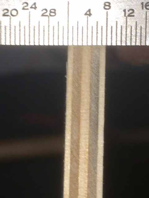

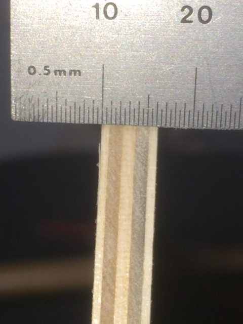

Postby KTM_Guy » Fri Feb 16, 2018 10:45 pm
I have been in a lot of Home Depots and have never seen real Baltic Birch in one. BB will come in metric sizes and until recent sheet sizes were around 60"X60". the place I buy from is starting to carry 4'X8''s in some sizes. I like the 5'X5' and that is what I get most of the time.
This is what 6mm BB looks like, it's five ply and is real close to 1/4"
I like Baltic Birch and I think it is a bargain compared to the crap they sell at the big box stores. I pay around $16 per sheet of 1/4". The down side is it is heavier than normal plywood and it is tough on cutters and blades.
Try to find a wholesale hardwood dealer in your area and see if you can buy from them. Let them know you;ll be buying 20+ sheets.
Good luck

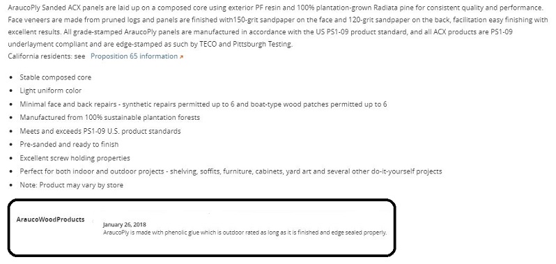

working on it wrote: from another thread concerning plywood usage I happened upon a killer deal for pre-sanded, phenolic resin-glued plys, 3/4" plywood (for $25 a sheet)
  • I started my build with a great quality sheet of 1/2" birch plywood, that had been leftover from a flooring project we had done many years before, using it for several rooms in our old (now demolished) home. We had bought a lot of it at a now gone Payless Cashways store, that had a complete lumberyard type operation , unlike the Home Depot or Lowes stores, so it was pretty good stuff. I only got to use the one sheet, because my wife was keeping 4 sheets in our shed, to use later, but I had purloined the one before she knew it. After being stored for a decade, it was still perfect, but I had to cover it up with a 1/4" Luan sheet, which was needed to bury the carriage bolt heads that secured the deck to the frame. So, I needed more plywood to build the upper structure, which I obtained from a Home Depot, that I had gone to, originally seeking hardware for my trailer.
  • I (and my friend, at whose shop I was building the TTT, 50 miles away from my home), were looking over the plywood there, with birch being very expensive, and oak slightly less, as my original preferences (we didn't know of any lumber yards nearby, so HD was our alternative). I demurred at buying 6 sheets at those prices, as I was on a no-budget build, hidden from the CFO wife. But, as we were leaving the store, we saw a stack of plywood sheets not in the normal place, but with a handwritten sign pricing them at $25 each. I looked them over, counting the plys and checking their quality, as best I could. They had a branding sticker on them, Arauco, so I used my web-browser on my flip-phone, to look up their website and check them out. It took quite a bit of time, as my phone was maddening-ly slow...an AT&T feature phone with an abysmal browser installed.
    Samsung Rugby 2 flip-phone (used from 2010 to Sept.2012).JPG (121.76 KiB) Viewed 2530 times
    not really good for internet use, but a tough reliable phone
  • Araucoply sanded plywood, .703 thickness, with phenolic resin bonded core.JPG
    Araucoply sanded plywood, .703 thickness, with phenolic resin bonded core.JPG (81.08 KiB) Viewed 2530 times
    not marine Baltic Birch, but a darned good plywood, afterall
  • My research on the website showed me what I was wanting to see: that the plywood had phenolic resin, and was pre-sanded on both sides. And with minimal patching, and no apparent gaps between the 5 or 7? plys, I decided to purchase 6 sheets, quickly, because there were only 8 sheets left (half the stack had gone, while I spent 30 minutes on my slow phone).

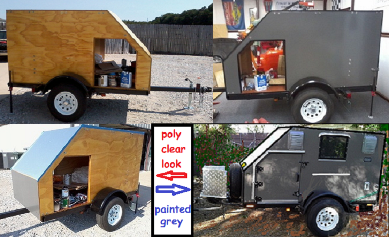

  • Since I was going to use a good coating (to be determined. later), I was wiling to get the softwood ply, instead of the hardwood birch, I originally sought, because the good coating would protect it, just as well (I hoped). It turned out to be a good choice, because it turned out to be easy to work with, and readily accepted my choices of polyurethane, "the mix", and outdoor-Acrylic enamel paint (without any sanding, on my part). After a 2-yer build, and 4.5 years of limited use (it's stored in a garage between trips), I have seen no faults with the Arauco plywood...still straight and flawless. Sometimes I wish I hadn't completely covered-up the plywood with my paint scheme, because it looked so good with the clear polyurethane base covering.
    which looks better.png (734.66 KiB) Viewed 2530 times
    sometimes I wish I had left it as a "woody"
