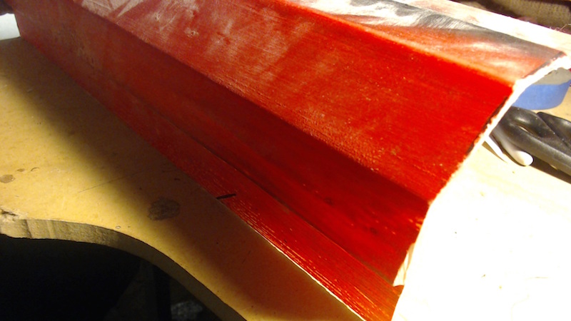

I went partners and received 20 sets of the preform railtop / trailtop kits and 400 running feet / 122 meters of railing . As I like to add side boxes made out of this .One with drop down sink /food prep . The other with a eccotemp L5 tankless water heater . Don't want the fiberglass to burn. If you have one do you think wood may burn behind the unit. I like the boxes to be 9 in / 23cm deep .What your though on this? :campfire:

You mean like this ? How does that all fit together … ??? Isn’t there an insulated metal shield you can use for that ??? :thinking:
Think rain guttered at your house .You just cut and bond.
Had not even thought of that. Just thing a flat sheet metal would get to hot and need to place thick spacers .
