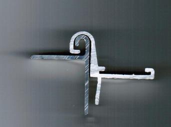

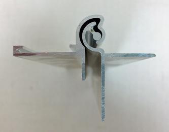

Need to order my hurricane hinge for the pantry.
I have no idea which style I need.
Hinge 1
Hinge 2:
Hinge 3

It all depends on how your hatch sits (flush or raised) with the rest of the body.
2 and 3 are basically the same. 3 looks like it has a spacer.

It depends on how you are constructing your hatch. I build a Fredrick's style that is the same elevation as the roof.
So I use the second one in your photo lineup. :thinking:

As far as the second two hurricane hinges, it depends on your hatch design. Check out their images in the link below. If I'm not mistaken, the hinge in your first image is just a different style joint, and designed for a 1/4 roof to hatch offset.
