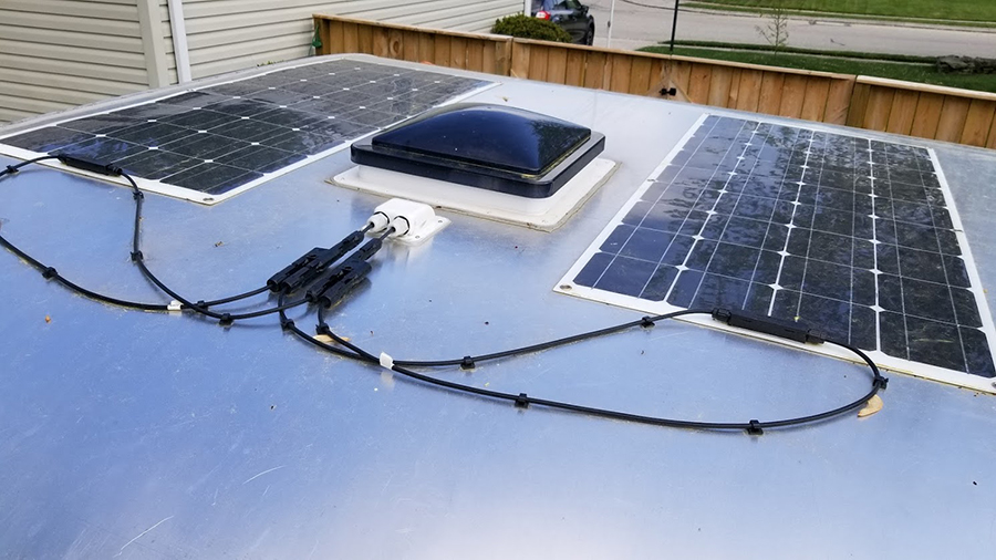

We attached two 120w flexible panels to the roof of our little Scotty project, using VHB tape. Works like a charm! If I recall, in direct sun we can pull about 12-14 amps. The nice thing is we don't have to worry about them walking away if we leave camp, so they are collecting sunlight from sunrise to sunset. With that said, I do plan on picking up a smaller 'portable' 80w panel that I can move around and put in direct sunlight for an extra boost if ever needed. There are pros and cons to both 'permanent' and 'portable'.
EDIT: just realized I posted our solar info here: viewtopic.php?p=1237055#p1237055
