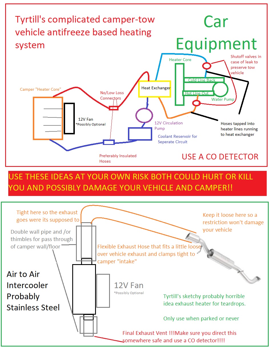

I had a couple of thoughts on this myself and decided that the diesel heater would be easier and hopefully less likely to break. However....
My two thoughts
You could use your breakaway line idea with a small "heater core" with a 12 v fan but I highly recommend if you pursue this you have a seperate loop that way if your system fails and starts to leak your tow vehicle won't be compromised. Here is a video for a shower setup but it's a similar idea.
The other is a little out there. Use an air to air intercooler made out of stainless steel to use exhaust to heat the camper.
Once again I didn't think they were great ideas but they were options as both would theoretically work and the antifreeze version I thought I could have a couple valves and have a shower tapped into it as well. Make sure you are careful about carbon monoxide and use a detector if you have a possible source of it.
You could also do a version where you have a 12v pump circulating water through a reservoir in a fire to the heat exchanger.
None of these are very good options for sleeping and staying warm.
