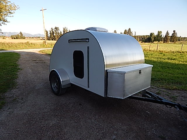

Postby tinman52 » Wed Mar 04, 2020 9:31 am
Hi all
Been thinking about how to attach a simple awning to my TD.....needs to be detachable/easily stowable. I don't want it permanently attached, but some anchor brackets for it on the TD would be okay. Size maybe 6x8 or so? just big enough to sit under or keep the sun out of the camper if I have the door open...
I have one of those pop up 10x10 shelters, but since I travel alone they are tough to set up, plus they are bulky. Looking for some ideas for something simpler.
So what do you all use for an awning? Please post pics or ideas... Thanks!
BTW, my TD is 4.5ishW x 8'L

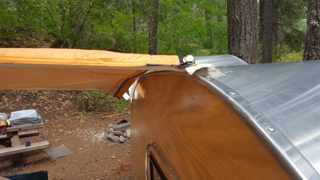

Here is a picture of a canopy I use at the side of my trailer. So simple that I was able to sew it. It uses two fiberglass sectional tent poles crossed under the canopy and aluminum poles to hold it up. It uses an awning rail mounted to the side of the teardrop. Since mine is a woody, I used a wood awing rail.
147699
I do like the one pole, regular tarp idea too.

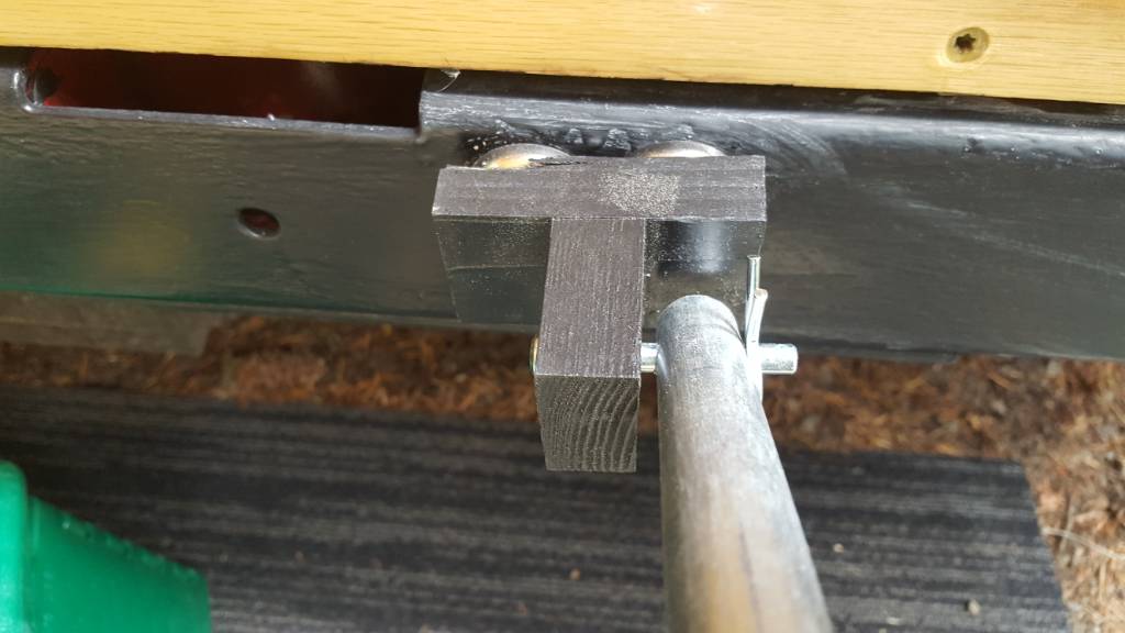

So I have a dog, occasionally he must be on a tether, so no awning, or side tables can have legs to the ground. I epoxied a rv channel to the roof, bent to fit. Use heavy duty magnets to the trailer frame for a test. These show pvc frame, moved on to foldable steel channel from old ez up.
Works great
