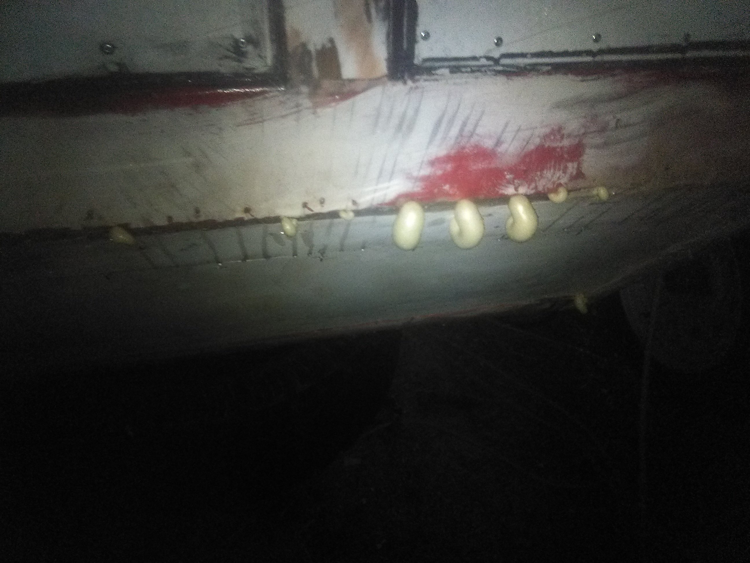

The easiest way is get a vibrating saw . cut inside skin small area . plan to cover with something nice .That way you can see . Frist #1 before you do anything do a tap test .Take a quarter tap the wall for changing sounds. At the shop To find hard to find leaks ,Can foam Spray a SMALL bit 30 to 1 expanding rate. will seal and come out any holes IN he picture .Could not even see the holes by just looking
