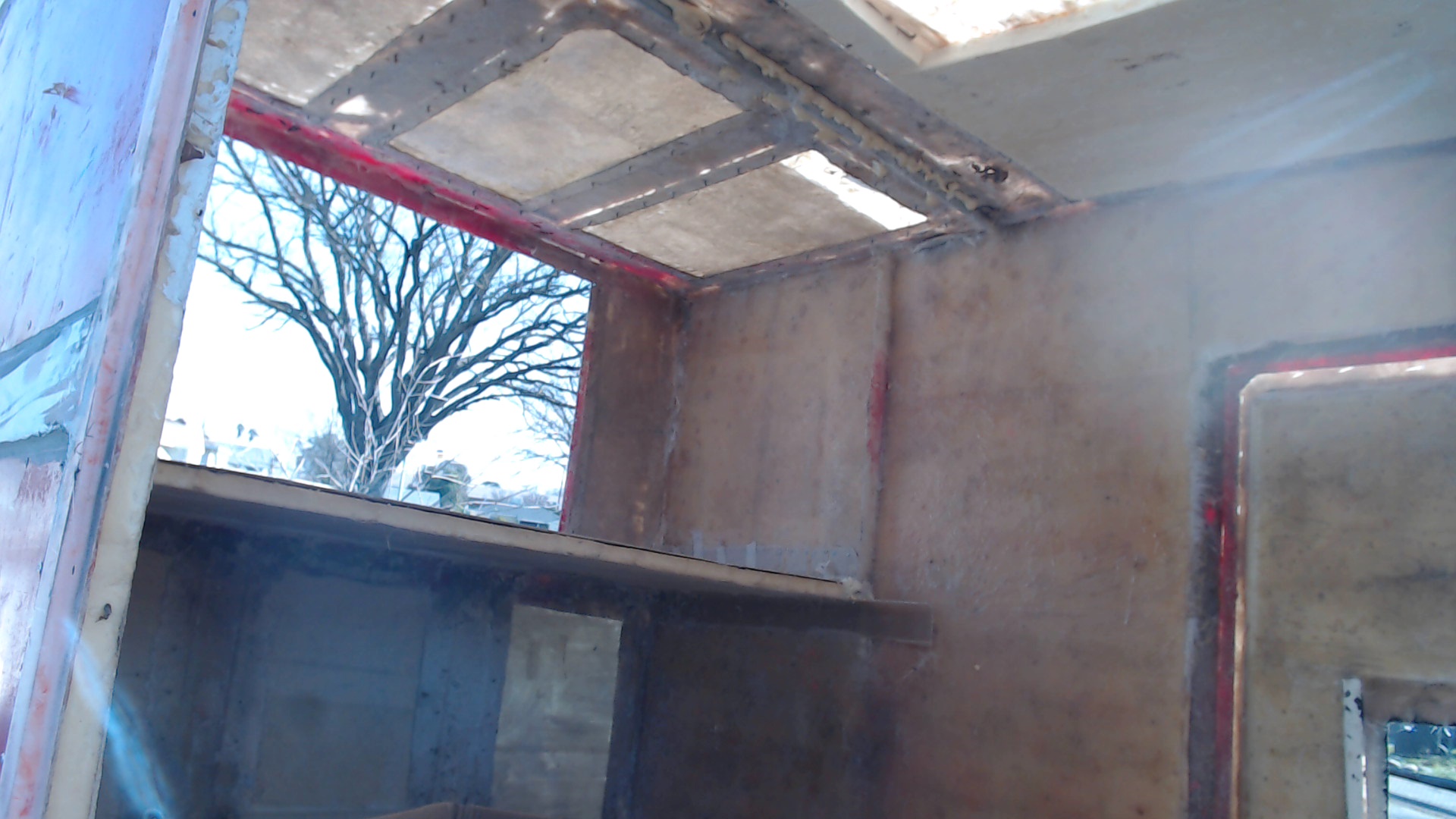

Postby saywhatthat » Sat Oct 31, 2020 12:50 pm
Why would anyone WASTE cash on epoxy over foam. Anyone tells you that Poly resin will eat the right foam HAS no clue. There pis off that they wasted there cash. Are 100 year pods are about 145 lbs with glass out side 1'' of THE RIGHT FOAM glass on the inside .With willy windows 4.5 wide 4.5 height b 8 foot long Using a fiberglass trailtop component frame kit. poly resin is about 9 lbs a gal

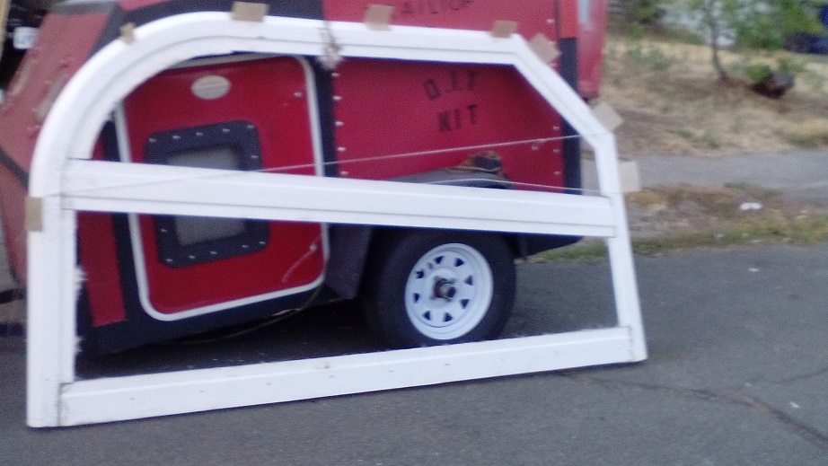

Postby saywhatthat » Sat Oct 31, 2020 1:41 pm
Fiberglass is heavy? Yes a full fiberglass trailer maybe heavy . with the RIGHT FOAM . the foam is the structural . the glass keeps you from putting your finger through the foam. again a wast of time and cash paints you can paint it with then use polyester resin, but make sure you use it right and enough of it. if you time gose for $.10 a hour you save some cash and have a weak piece of crap how Hard can it be use the right structural foam about $20.00 a sheet

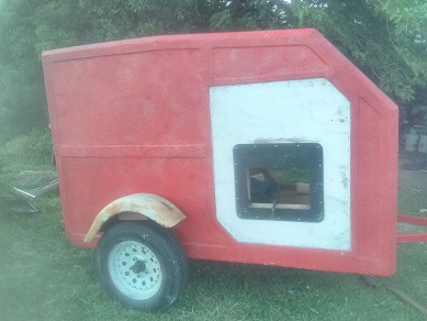

Postby saywhatthat » Sat Oct 31, 2020 2:31 pm
rise 007.jpg (51.97 KiB) Viewed 2179 times
Boats set in water trailers not so much .Iso insulation $20 a sheet at home depot. the design we use is not flat . we glue are wet lay up glass on sheet foam . Use can foam to back fill raise parts Don't let the name of the foam fool you it safe
