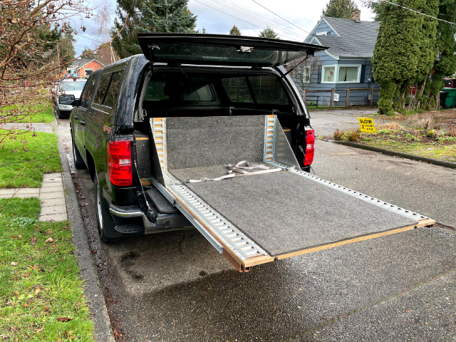

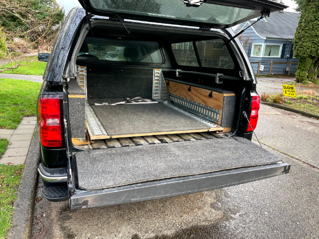

For the slide-out I was thinking doubling up on super heavy duty drawer slides. They're spendy but work. 5 years ago I built a pickup bed slide using them and I've loaded it with a yard of crushed rock among many other assorted overloads no problem. The one thing that caused the drawer slides the most problem was blowing sand. We live in Seattle and spend a lot of time down on the coast. The bed slide is great for camping and beach trips, it's like having a 4'x6' table and if it starts raining just slide it back inside the canopy shell. Anyway, for the slide out, I figure double 500 lb drawer slides and locking pins top and bottom of both sides should be about 2x or 3x of any possible load. Sealing is my biggest worry, but I plan to use RV slide-out lip seals, and bulb seals on an angle steel flange around both the inside and outside locked positions of the slide-out.

I considered building my pickup bed slide with DIY skate bearing slides. Thought long and hard about it actually. Drew up a handful of designs. I'm a skateboarder, so I've got lots of bearings rolling around here in the shop. After drawing up plans though, the skate bearing slide is actually bulkier than drawer slides, and only controls one degree of freedom. So you really need to build one set to control vertical and one set for lateral, and then they're about twice as bulky in cross section as HD drawer slides. Then there's the time factor to reinvent the wheel. And there's no cost saving either after you buy the steel/aluminum tube and a big pile of bearings and hardware. They could be stronger than drawer slides though. The ones in my pickup slide out are 5' long with 500 lbs capacity, and I've put much more than that on them. I didn't get the kind with lock in/out switches, so I had to fab up a locking lever system.
For a camper slide out application they would have a pretty easy life compared to my pickup bed slide which gets beat to h e double hockey sticks. It's still working though. After having a bed slide in my pickup, I couldn't live without one. Mine gets used almost every day and I love it. I would even buy an off the shelf one if I had to.

The guys who do the skate board bearing slides, normally just run a hdmp strip down the side to stop/smooth any side to side movements.
Yes they are 1 inch per side in width and about 3 inches tall, they are lot stronger than drawer slides. I bought a set of 400 lb rated drawer slides and they failed pretty quick. The ones I have now weigh about 75lb for the set of 2 for 48 inch, and they are 3 inches tall and 3/4 inch thick. So not really any smaller than skate board bearing slides. Here is a thread with some good pics, of bearing slide over at expo portal. He actually sits in the drawer to show how strong it is.
