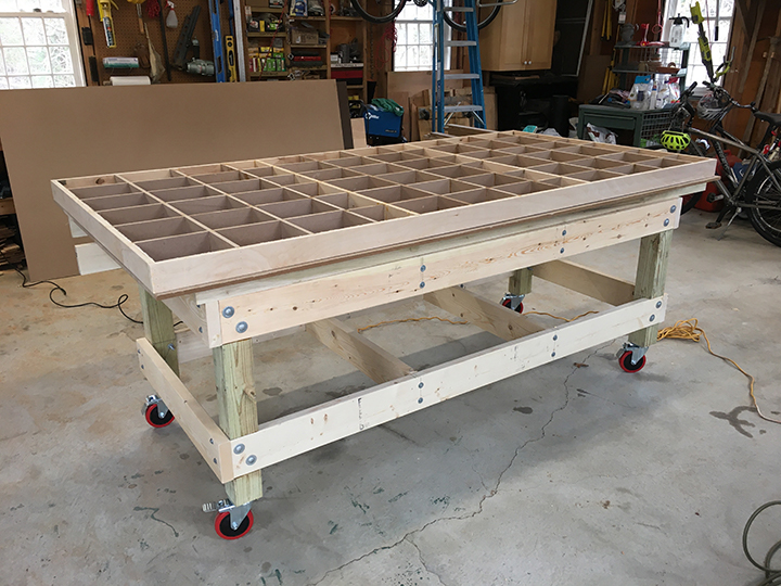

On another note, I'm coming to realize the planning for this trailer takes much time.... and so does the prep. Gathering necessary tools, preparing the work space.... etc. I had seen other members have a large table to work on
so the last few days I spent building a torsion box table, 4' x 8'. Came out nice and flat. Glad I took the time to do this.
Thanks again for any help with the 3 questions.

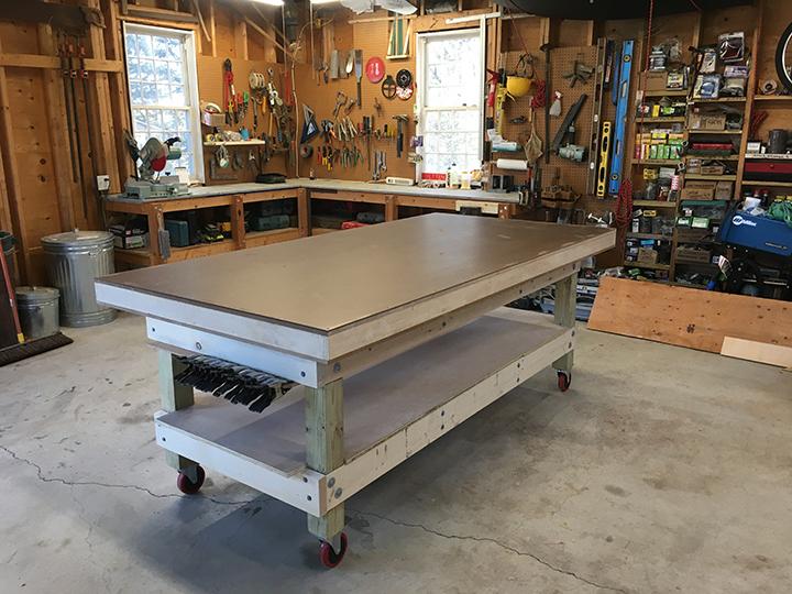

Postby Tom&Shelly » Wed Apr 14, 2021 7:39 am
Nice table! Ours was a lot more basic (3/4" plywood on a 2-by frame)
154710
But, now that our build is finished will be a center-piece in our shop.

How do you intend to use the torsion box table? It seems like that workbench alone is probably all you would need for this work.

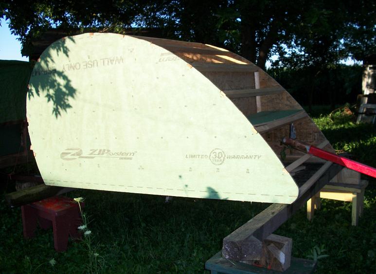

I built the cabin on the frame because I never imagined removing it.
As far as reverse light, I ended up with them by happy accident. It’s a little hard to see, but the “stripe” visible on the lowest piece of wood here is one of the LED tailgate tape lights for a pickup. I got it cheap, then forgot about it a few months. When I got ready to install it, I saw five wires. I hit each in turn with 12v to see what happened and bang, bright white.
I did the tape light to get mo brighter. People love to tailgate.

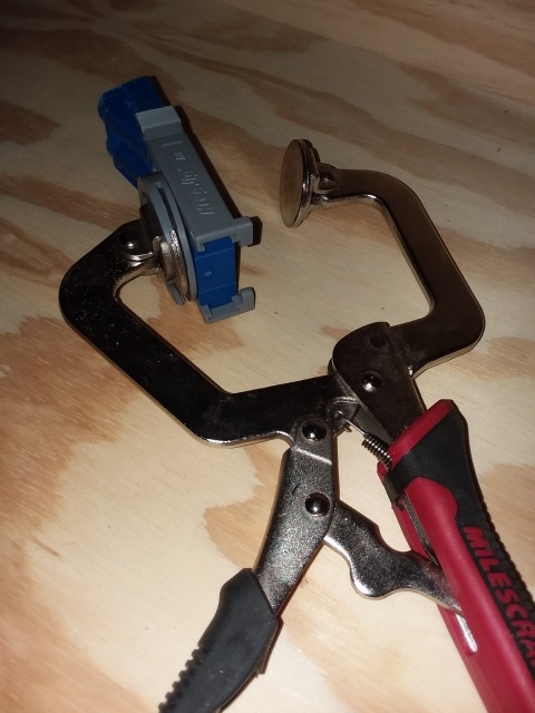

John, I have the basic Kreg jig and it is well made and works great. I went years using a basic bar clamp to clamp the work for drilling (Tom shows one in one of his photos). I finally broke down and bought a clamp like this...
https://www.amazon.com/Milescraft-40010003-FaceClamp-Woodworking-Welding/dp/B06XYGLPDV/ref=sr_1_41?dchild=1&keywords=milescraft&qid=1618413415&sr=8-41
Do yourself a favor and get one of those and you'll be happy. Kreg makes their own model but they are a bit pricier than the Milescraft. The Milescraft I have is well made and will stand up to years of use. They offer several sizes, I bought the 3" to do heavier material. The two inch is available in a kit with the pocket hole jig.
Here
https://www.amazon.com/Milescraft-PocketJig200XCJ-Pocket-Bundle-Clamp/dp/B084SW48T6/ref=sr_1_7?dchild=1&keywords=milescraft&qid=1618413758&sr=8-7
There are special clamps for clamping the final joints as they are screwed together. One end goes into a pocket hole and secures the joint while screwing into an adjacent hole. I've never used one and maybe others here can chime in whether they are worth buying.
Here
https://www.amazon.com/Milescraft-4004-PocketClamp-Pocket-Joinery/dp/B079W2K8XY/ref=sr_1_47?dchild=1&keywords=kreg+clamp&qid=1618414158&sr=8-47

Nice mobile bench.
I build my teardrops on the chassis that is supported by and shimmed to level with 4 cement cinder blocks on end.
Like your mobile bench, I can move the work in progress simply by mounting the tires and wheels.

TimC wrote:John, I have the basic Kreg jig and it is well made and works great. I went years using a basic bar clamp to clamp the work for drilling (Tom shows one in one of his photos). I finally broke down and bought a clamp like this...
+1. I bought one of those later. It puts more pressure on the jig than a bar clamp. Be careful though, I looked at one at Home Depot that looked like the right thing (I don't remember the brand--probably not a Milescraft, and definitely not Kreg), but it simply didn't put any pressure on the "clamped" surface. A total useless piece of metal.

And I was just working on the kid's galley and discovered the Milescraft's fat pad fits inro the Kreg nice and firm so aligning was much easier without having to place the clamp on the pad each time.
