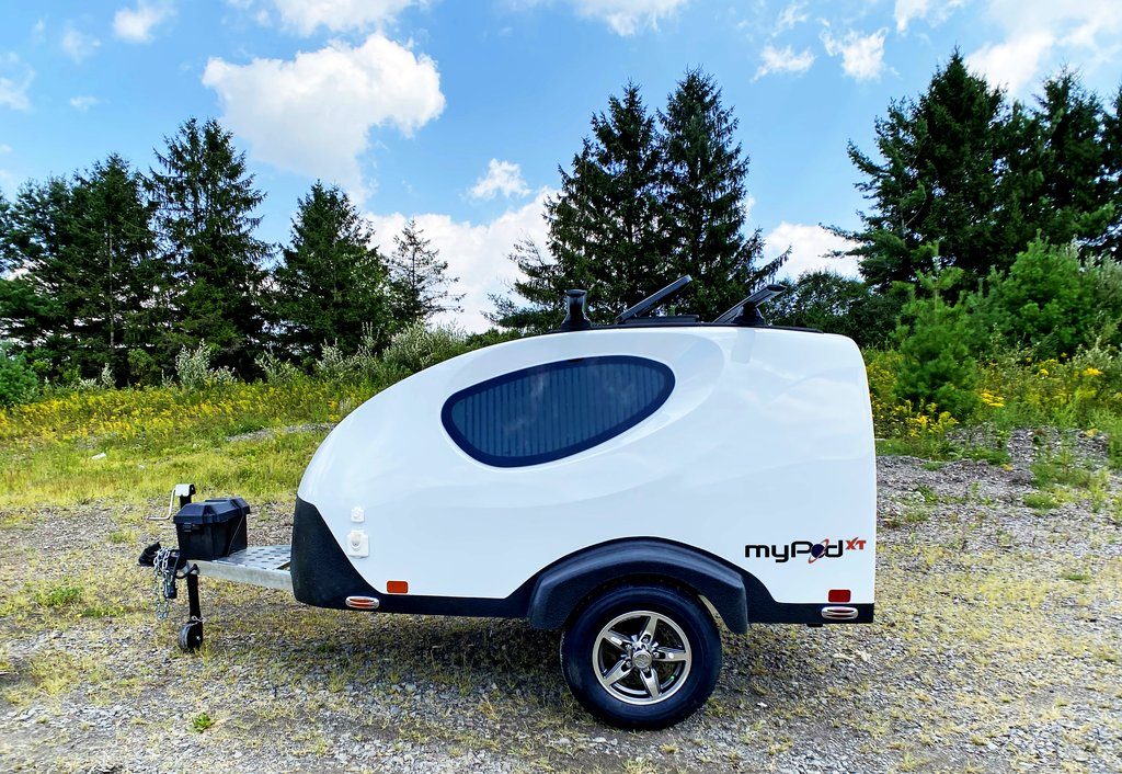

So due to the tow vehicle the theory does not work for a teardrop the normal way or the theory does not work for it turned around? Obviously having the edge of the reversed teardrop below the tow vehicle's bumper will not do much. I am talking about a slope up from about trunk lid height. And what is considered a mid sized car now days. Not a SUV or truck.
This one is more like a reversed teardrop.
