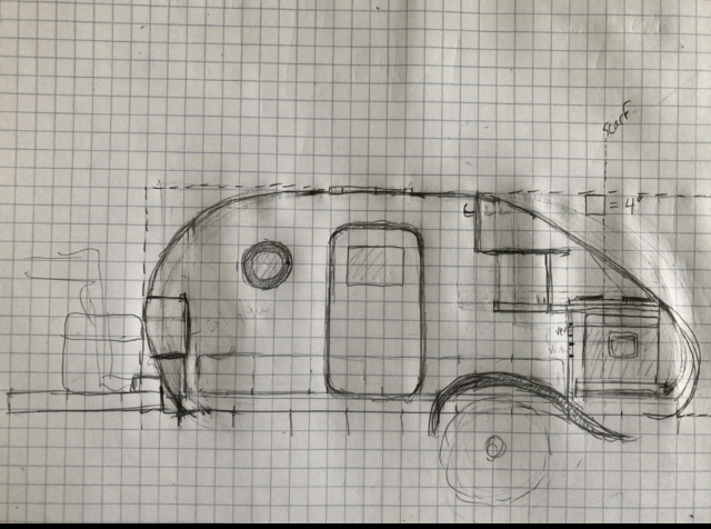

This is my first rough sketch. I have a 5x9 trailer, I drew the deck, added the bed, there’s 7 feet in there, then my kitchen including a vintage three burner chrome Coleman stove, and my biggest cooler. Looks like it will work. Thoughts?

Postby Covebrian » Thu Jul 01, 2021 4:14 am
Have to work out that curve on the back over the cooler though…or slide the kitchen forward a few inches…

Postby tony.latham » Thu Jul 01, 2021 9:24 pm
Your sketch skills are 10X above mine.
You might widen the doors since you get in a teardrop by sitting in the doorway and then swinging your legs in. I like a doorway that is halfway up the mattress. It helps keeps the bedding in place but you still sit on the mattress, not the doorway.
Make sure you design in the hatch thickness so it doesn't impede on the countertop and stove.
:thumbsup: :thumbsup:
I look forward to watching your build come together.

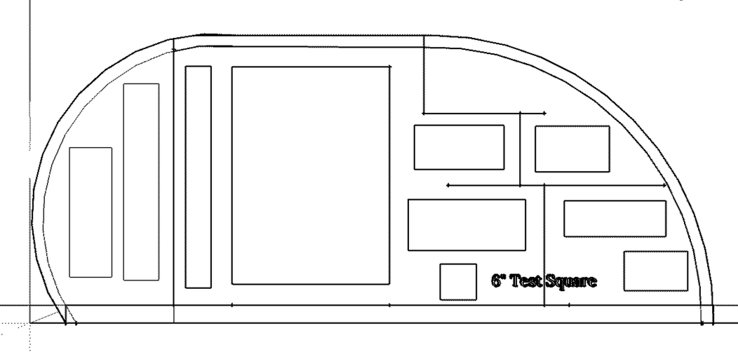

I'll probably be buying a foam mattress and cutting it down to size anyway. I have a new sketch up plan, not as interesting a shape in the back but there's room to modify later. This gave me a much better handle on space then my original sketch. My bed length is down to 6'7".The gap around is 1.75" to accommodate the 1.5 2x2 and two sheets of 1/8 ply with a three inch overhang to hid the trailer frame and I took Tony's suggestion to move the bottom of the door up. Might need to move up a bit more to accommodate the floor...
