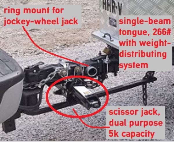

working on it wrote: I can no longer lift the 266 lb trailer tongue to shift position in the garage bay, nor can I swing it around outside to be able to use my front hitch, to store it in the garage bay. So, I figured that a 500 lb limit, industrial swivel caster would work fine, when mounted to my current jack's sand foot.
154322
For $20, and an hour of my time (looking for some locknuts, mostly), I now can move it around OK. The eight inch diameter wheel rolls easily on my mixed surface driveway, and also raises the tongue high enough to easily hook-up to my tall hitch. Win-win.
* Well, I was wrong; adding the 8" jockey wheel made the tongue sit too high to easily hook up, or unhook from either the rear or front hitches, so I added a 5000 lb 24 inch lift scissor jack on the tongue, next to the detachachable jack (now with a wheel).https://www.tnttt.com/viewtopic.php?f=2&t=70954&hilit=+scissor+jack&p=1238323#p1238323 Now I use the scissor jack to lift and lower the tongue, adding or detaching the "roller" jack as needed.
WD spring-bar is removed prior to stowing-in-garage procedure
tongue-mounted scissor jack.JPG (66.87 KiB) Viewed 1070 times
* At campsites, I'll roll the trailer into final position, if not quite perfect after backing in, then detach the rolling jack, and use the scissor jack and two rear stabilizers to level it. It takes a few extra steps, but it works for me.

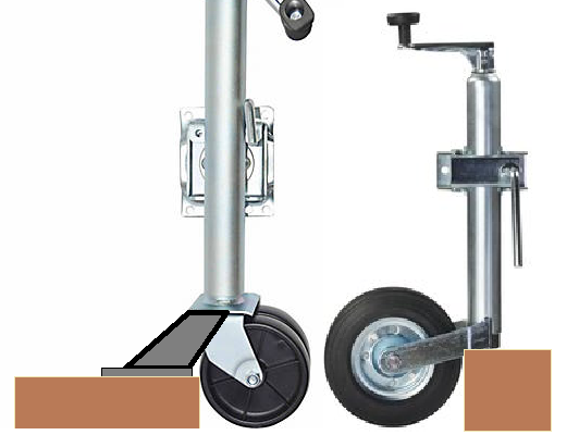

I do, however, only use the wheel styles that allow me to put a block under the support tube, or I weld on a 'foot' that I can set on a block for stability. Best of both worlds.
My trailers are all wrapped up for the winter and I can't find a photo. So, here is a simple illustration:
I also add a spike or two to the bottom of flat feet, so they don't walk when placed on a board.
