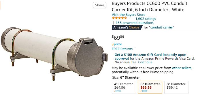

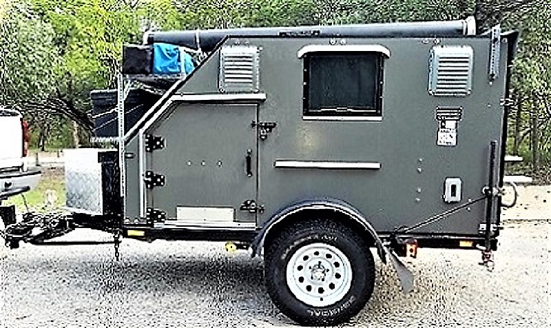

* My short 4x8 trailer is comparable to a short bed camper shell in length; a storage tube (usually used by plumbers & electricians to store pipes or conduit) atop your shell would work. I bought a 10' long 6" diameter pvc pipe at Lowes, cut it down to 8' (all I needed) and installed a
Buyers Products CC600 PVC Conduit Carrier Kit, 6 Inch Diameter kit from Amazon. The kit consists of tube ends (one is lockable) and the clamping brackets (big U-bolts) needed to mount them on the vehicle. I could've gotten a 4" diameter or 8" diameter kit, but the 6" x 10' pvc was best for my purposes.
* See these two partial threads to see what I did: https://www.tnttt.com/viewtopic.php?f=32&t=70709&hilit=+fishing, and https://www.tnttt.com/viewtopic.php?f=2&t=70367&start=15*
