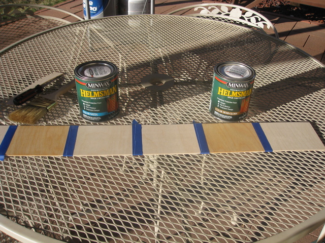

Here is the test panel with just the 209 applied on a couple of the test panels before any poly is added. The 209 has had a full day to dry. The 209 stain is supposedly a clear sealer but does darken the wood slightly. As you can see I am testing two versions of Helmsman, satin on the left, and semi-gloss on the right. Each version of helmsman will be applied to both a panel with 209 stain as well as one with just bare wood, both are sanded to 220 grit.

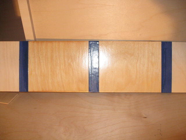

Inside lighting after 3 coats. Here the satin Helmsman covers both panels, 209 on the left and bare wood on the right.

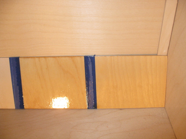

Same as above but with the semi-gloss version.

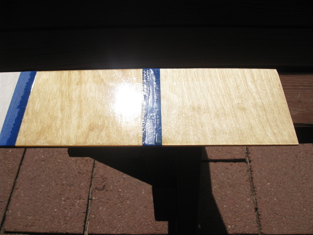

Satin in natural light.

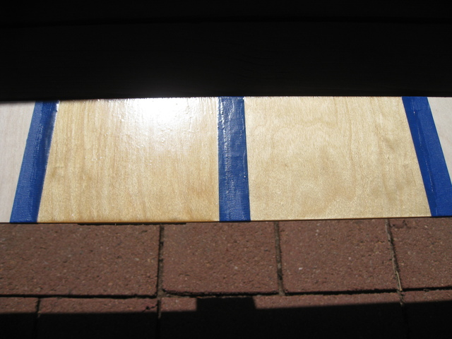

Semi-gloss in natural light.
After seeing the outcome I think I am leaning toward the satin without the 209. The poly seems to tint the wood enough, andwith the 209 added, it becomes too dark and and slightly blotchy around the grain.
