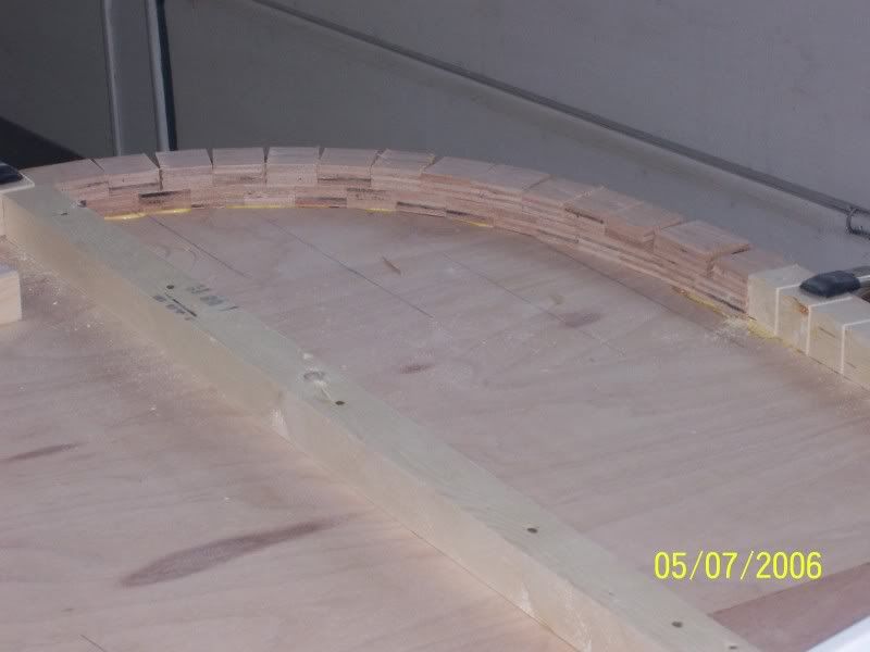

Postby RandyG » Thu Dec 12, 2013 5:51 pm
112040
Here is mine, 1/2" wall with 1/4" inside panel. I cut the frame cutouts for the foam with 2-3" radias' to reduce stress cracks. Another 1/4" panel will go on the outside with canvas over that. If I used frp, I wouldnt think one would need the outer layer if the foam inserts were flush, mine are bout .040" shy from flush.
Randy

Postby charlescranfill » Thu Dec 12, 2013 6:06 pm
I like the radius corners idea. I think if I use 3/4" plywood and 3/4" foam it should be flush, no? That's a real question, I'm learning as I go. Computer nerd here. LOL

Postby RandyG » Thu Dec 12, 2013 10:09 pm
I have noticed most plywood isnt exact, neither is the foam. If you can find the material you plan on using and put some calipers on them, or a small scale. I should have done that before :?

Postby aggie79 » Fri Dec 13, 2013 9:05 am
charlescranfill wrote:I like the radius corners idea. I think if I use 3/4" plywood and 3/4" foam it should be flush, no? That's a real question, I'm learning as I go. Computer nerd here. LOL
Stndard 3/4" plywood is actually 23/32" thick. MDO plywood (medium density overlay) can be obtained at a true 3/4" but you can't get it at big box stores. The closed thickness to 3/4" for Russian or Baltic Birch plywood is 18 milimeters.
All of the above really doesn't matter since foam insulation - especially the "pink" or "blue" - varies considerably in thickness. It can be easily sanded to thickness but you'll need to peel off the plastic or mylar water barrier on the outside if one is present.
