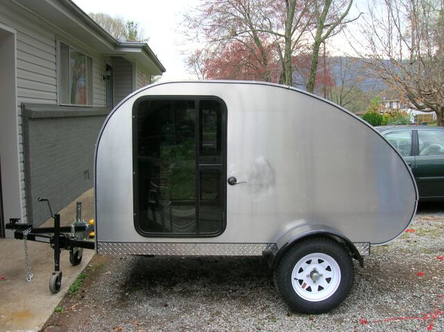

Postby Jim Marshall » Sun May 14, 2006 9:28 pm
Finn, this is the way we hid our frame.

Postby Jim Marshall » Mon May 15, 2006 2:42 pm
Thanks my friend, I appreciate that a lot. The main reason I used the skirt is I didn't want to buy aluminum wider than 4 foot, and I didn't want to lose the few inches of head room if I were to have lowered the walls to cover the frame.

Postby Classic Finn » Mon May 15, 2006 3:01 pm
Jim Marshall wrote:Thanks my friend, I appreciate that a lot. The main reason I used the skirt is I didn't want to buy aluminum wider than 4 foot, and I didn't want to lose the few inches of head room if I were to have lowered the walls to cover the frame.
I was looking at that lowering bit too.. lose some head space.... indeed..
