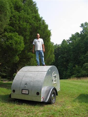

I painted myself into the same corner :D
My solution was to cover the tear from the front lower edge to the top of the hatch with hard board twice. The first layer gave me the 1/4" gap for the trim and seals and the second layer kept the hatch and roof on the same plane. In essence I built up a notch rather than cut it out of my galley sides.
I added a few pounds to the tear due to my mistake but I ended up with a tear I can walk around on for what ever that is worth.
I had gotten those curves just the way I wanted and couldn't risk screwing them up with my router. I could just see getting away from me.
worked for me
