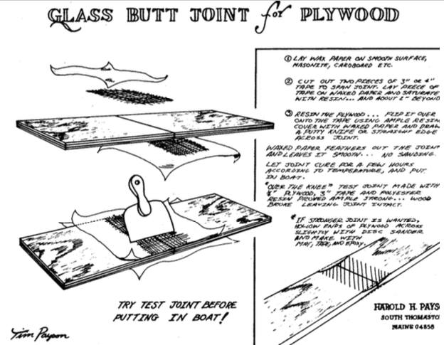

Postby swoody126 » Sun Apr 18, 2021 10:44 am
30dayreviews, w/ the skeletal joint ahead of your door i might suggest placing your seam on the aft edge of the door opening which would provide the least possibility of issues
that would automatically provide a reasonably good butt joint backing butt block
on the outside i'd suggest using H. H. "Dynamite" Payson's method to hide the seam AND reinforce it
when hollowing the underlayment out try knot to go thru the entire thickness(2/3)
once a layer of cloth is in place make sure it is totally saturated
hand block sand to surface level
BON CHANCE

Postby 30dayreviews » Sun Apr 18, 2021 3:21 pm
swoody126 wrote:30dayreviews, w/ the skeletal joint ahead of your door i might suggest placing your seam on the aft edge of the door opening which would provide the least possibility of issues
BON CHANCE
sw
I should have mentioned that the seam will end up being on the back end of the trailer where it is backed by 3/4 ply completely. not sure I need to hide the seam as there will be filon on the outside of it so its not going to be visible. guess my main consirn is with any moisture that might get into is over time.. hopefully no time soon.
