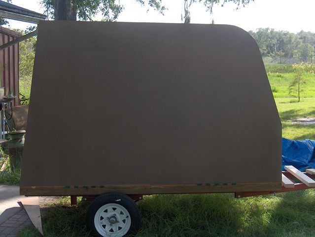

My TTT will be taller than 48" so I will need a seam on the side.
Question.
Is it better for the seam to run verticle or horizontal?

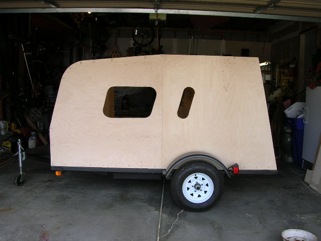

Postby mikeschn » Sat Aug 12, 2006 4:52 am
I made my seam vertical. It's backed up with a 1x3 piece of wood, and screwed in on both sides. I plan on filling the joint with Epoxy putty and sanding it flush. I think it'll be both strong and invisible! :o

So I'd say go for a horizontal seam and plan on adding a small cover strip over the joint - like a belt line on a car. To get the right look, I'd say make the bottom piece 2ft high (so you can cut two from one 4x8). From the looks of your template, you have a natural line running from the knuckle in the front at about 22" off the deck, so that's where I'd put a seam. For the cover strip, 1" wide half-round wood moulding would be ideal, with the ends cut to points.

Nice Profile! Where have I seen that one before? Oh yeah, Mine! I used 5' panels and ran the seem verticle with a 1 x 4 behind it. I didn't use and angled cut. Body filler cleaned it up. The sides are not 5' tall though.
