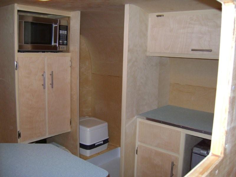

If you want to go REAL simple, you can do what I did. Purchase some 1/2" birch plywood, cut the doors, get some birch tape with glue pre-applied that you attach to the edges with an iron, then trim and sand. Here is a pic of some doors prior to finishing (which I've just started to do this weekend)
Nothing fancy but they have that "euro-look". (I guess they do...never been to Europe, but I've been to IKEA. Does that count? :lol: )

Donutboy wrote:If you want to go REAL simple, you can do what I did. Purchase some 1/2" birch plywood, cut the doors, get some birch tape with glue pre-applied that you attach to the edges with an iron, then trim and sand. Here is a pic of some doors prior to finishing (which I've just started to do this weekend)
That's a good way to go but the glue on wood tape isn't that good. The plywood core absorbs the glue. A simple solution is to size your plywood (like in wall papering) edge with yellow glue before ironing on the wood tape. It's a little messier but the wood tape will not delaminate. :D Danny
Very nicely done. That Birch is a Scandinavian Style characteristic. Looks very nice. :applause: :applause: :applause:
Thank for showing that. :thumbsup:
