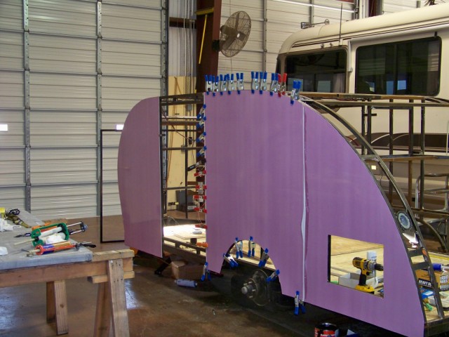

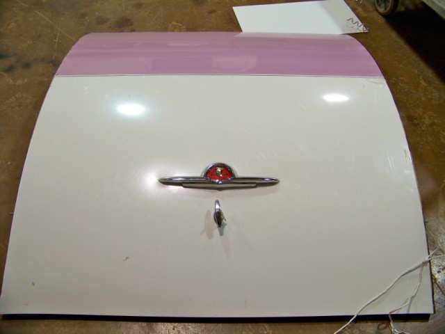

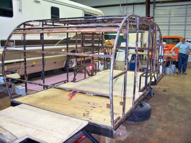

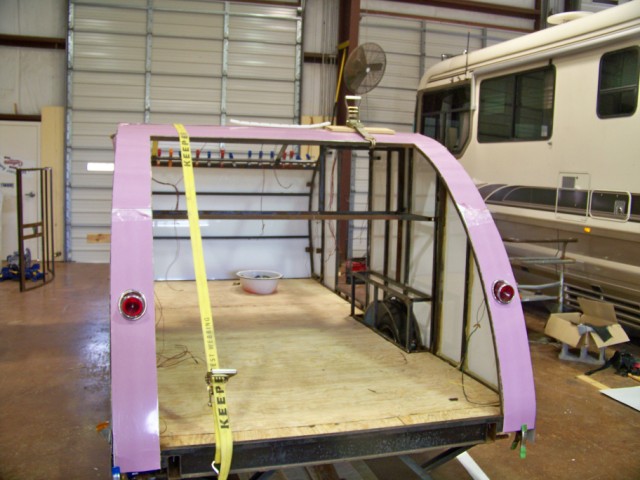

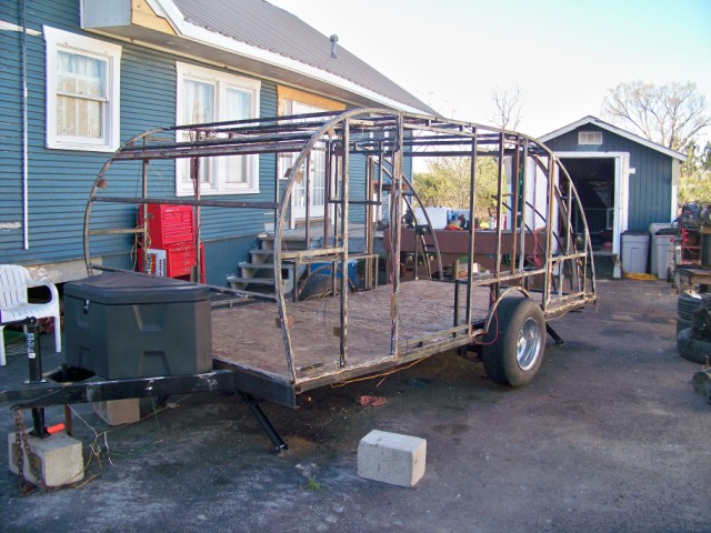

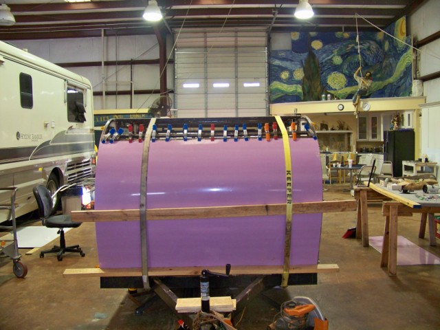

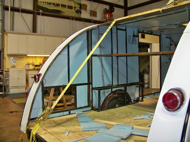

Well thanks to hurricane IKE we had to re-skin our teardrop. We had our teardrop tucked up next to our house for the storm but when half of my carport collapsed a piece of flashing peppered the top and the side. When went to buy more tin the color didn't quite match so we decided a re-do was in order. So we stripped her to the bones and started all over.
Image[/img]
And before anyone asks no it is not going to be lavender :lol:
I didnt know I would need so many clippy's :o
I plan on starting on the interior tomorrow and hope to have it camp able in 2 to 3 weeks if the whole Tx title fiasco doesn't kill us :cry:
there are other pictures in our album.
We really hope to see all the TX tear droppers at Spinnernuts Guadalupe Gathering it is going to be a great weekend.
Big DE :thumbsup:

I'm particularly interested in the way your hatch is inset from the sides. Can you say how you plan to do the vertical seals? Or are you going to build an interior rain gutter/channel like on a car hatch?

Aggie I plan on using t molding as a door jam with weather stripping. and im going to put t molding on the hatch with weather stripping and see how that goes. :worship:. We look forward to camping with you and hopefully you might be able to make it too Spinnernuts Guadalupe gathering in august.

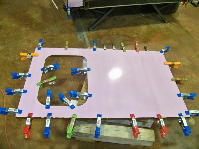

Postby Big DE » Fri Mar 13, 2009 3:08 pm
John,
I went to a sign supply company and bought a couple tubes of 2 part epoxy designed to join steel and AL. it was like $37.00 a tube and I had to buy a special gun to use it and it cost $93.00. So now that I had the double meat double cheese of two part epoxy's I thought it was down hill from there :twisted: I was wrong.after reading the SMDS I found out that it sets up in about 10 minutes. so buy the time I got ready to stick the second sheet of AL the epoxy was hardening up in the mixing tip rendering it useless. So I had to decide which were the most important seams to be glued and use it there. So for the rest of the trailer we used liquid nail construction. We had used it before and it was a real pain in the butt to get it off the frame when we stripped it. I did use a bead roller for all the seams and it overlapped each seam 1 inch. Then we used liquid nail on the inside gluing from behind. But if you ever happen to be coming thru Tx. on your way to a gathering and you see white AL sheet metal littering the highway just go ahead and pick it up and bring it to me ill be at the gathering. :rofl2: :rofl2:
