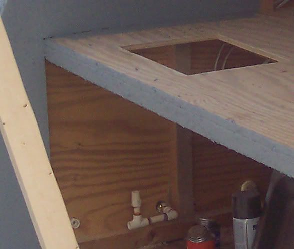

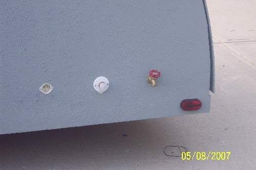

Postby Jst83 » Mon Feb 22, 2010 6:14 pm
d_lairson wrote:
Jst83 wrote:I also put in a splitter so I could get water outside in pans or buckets that won't fit in the tiny sink.
How did you run the water lines? Did you use pipe or hose or something.
Cheers,
David
Here's about the best inside shot I could find while it was in mid build, I used standard PVC piping. In the picture what you see is where the water comes in and splits I attached a flex hose from the threaded top up to the faucet and ran the pvc on over to the outside spigot you see the back of. I like to keep it simple :lol:
Hope this helps, guess I should get a better back shot of this when I get it out of storage in the spring

Postby Jst83 » Mon Feb 22, 2010 6:32 pm
kirkman wrote:I have a sink in my tear and I think if I had it to do all over again I would keep the faucet and skip the sink. I would just install the faucet so that the spout hung over the counter to fill pots and a dish pan. The sink takes up to much counter space.
I'm lucky my tear is 6'3" wide so it leaves me plenty of space, In the one I'm building now that 40" wide there's no chance of a sink.
I like the faucet on the outside cause any excess water just runs on the ground. you could hide the spigot behind a little door if you don't like it sticking out there for public display. For me it's a conversation starter :D
